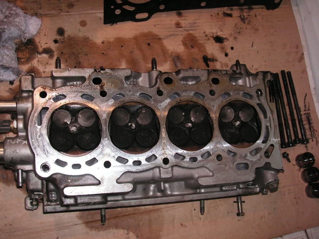

Cylinder head off. You can just see the tops of the exhaust valves (nearest the floor). On the inlet valves, the lifters are still in place - these are the really shiny bits - 8 in a row). These act as shims to set valve clearance from the cams (removed in this pic)...V important to check the shim sizes when installing new cams. The lifters are pretty expensive - £13+vat each from Toyota....

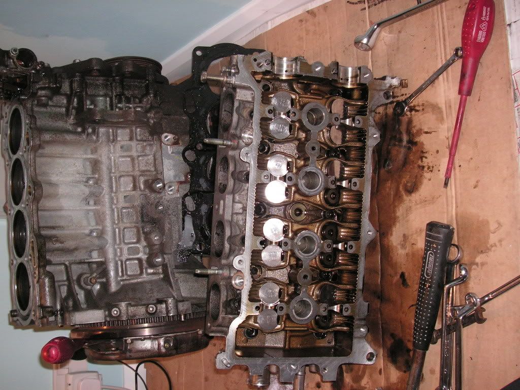

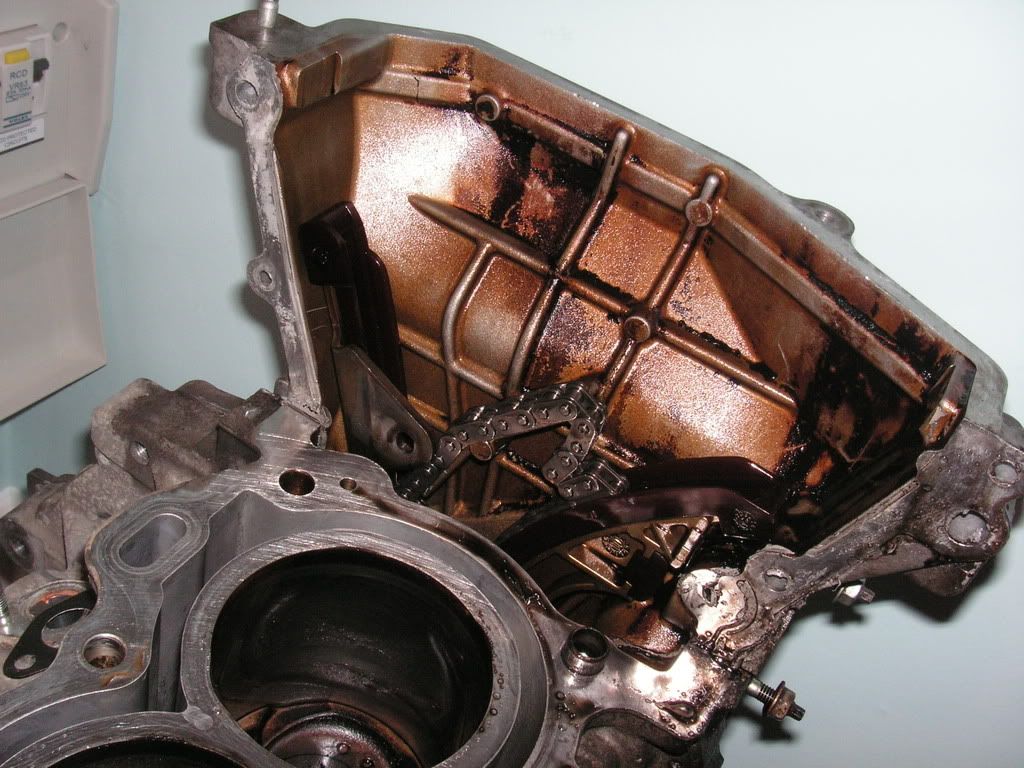

This shows the top of the block with the cylinder head removed. The big bit stiking up is the side cover / timing chain cover. You can make out the timing chain and the tensioner (RHS of chain) as well as the chain guide (LHS of chain). The side cover is sealed to the block using RTV sealant. Use the Toyota sealant when putting this back on as it contains the water pump and a leak of coolant past the RTV sealant can be into the sump. Thus contaiminating the oil and possibly wasting your big ends.

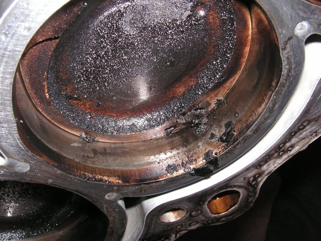

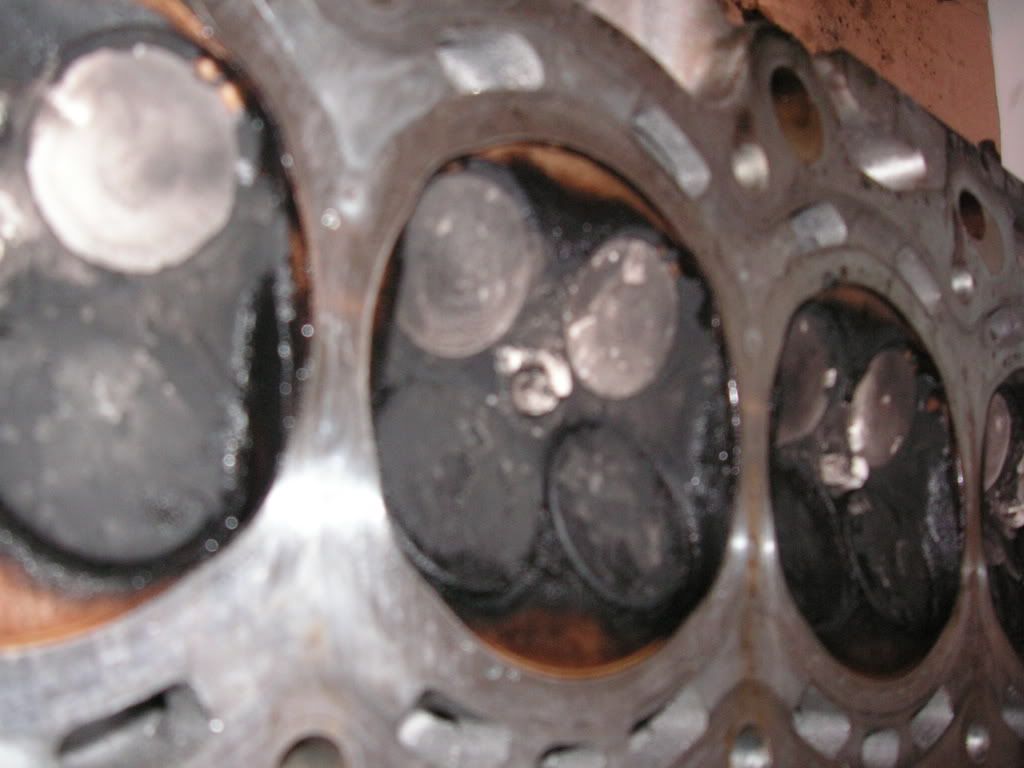

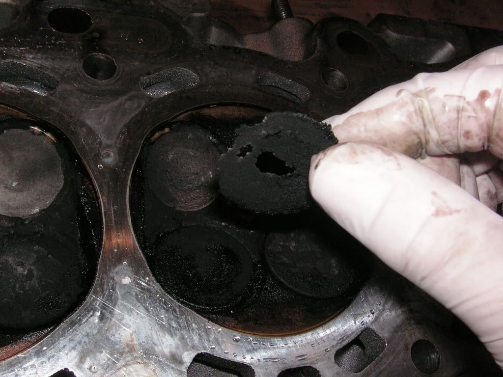

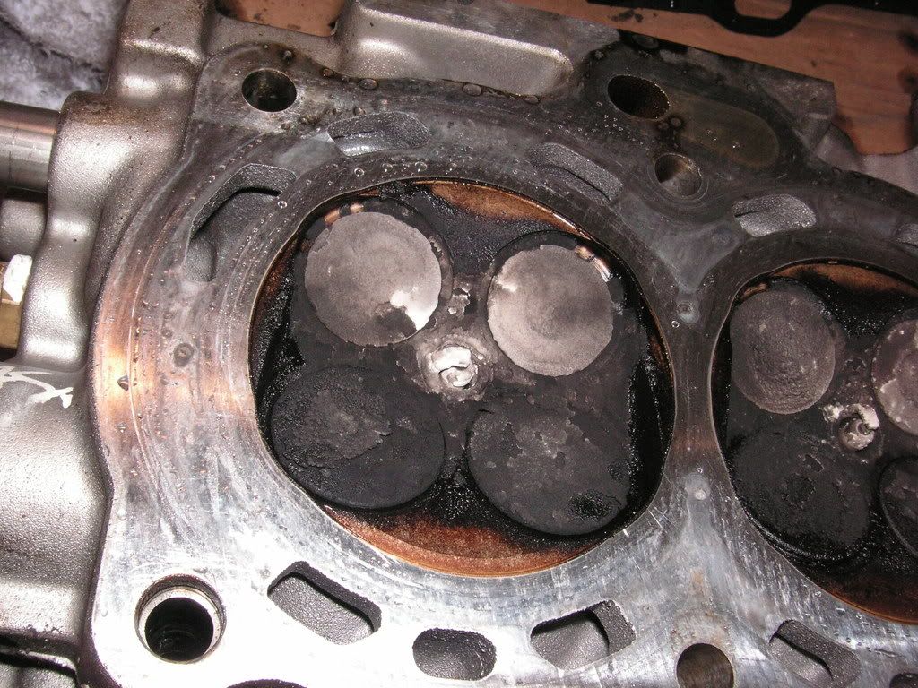

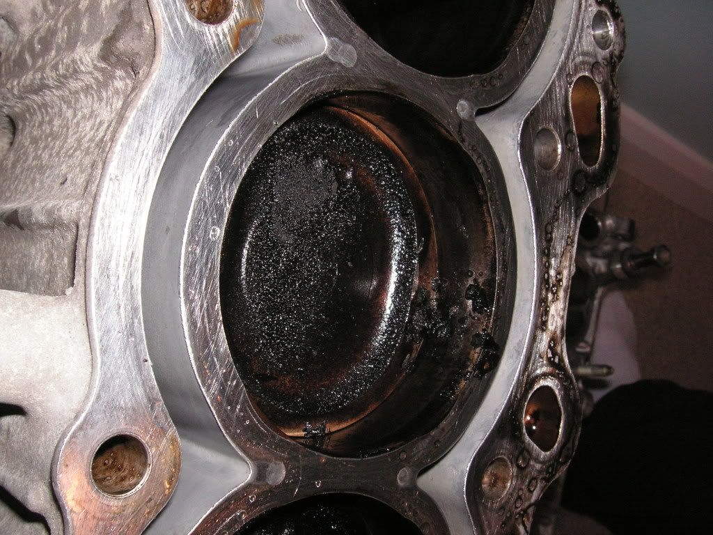

Major carbon deposits. The orange colour is basically organic varnish formed by a combination of high temp, oil contamination & fuel vapour. Nasty stuff. This is basically the stuff that 'glues' the rings on these (most) engines and gives oil use issues.

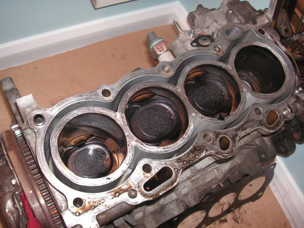

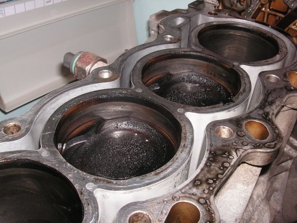

The bores look bad here but actually they are in surprisingly good nick. I was very suprised that the carbon deposits did not damage the bore.
All these carbon deposits fell from the cylinder head just whilst I was removing it. I did not put it there....probably it is down to the 10 odd litres of oil that the engine has consumed recently...
The carbon contamination of the combustion chamber is unbelievable. It really is as thick as it looks - in some places 2.5mm thick. Some of it flakes off but some of it takes a gouging by a chisel to get through. All repairable though....I have not see the seats yet though.
The engine reallyt was running. It was 'popping' a lot down the exhaust. Carbon deposits like this would be the cause as they exit the engine glowing red hot and ignite excess fuel that the ecu puts in to over oxygenation of the mixture hitting the cat.

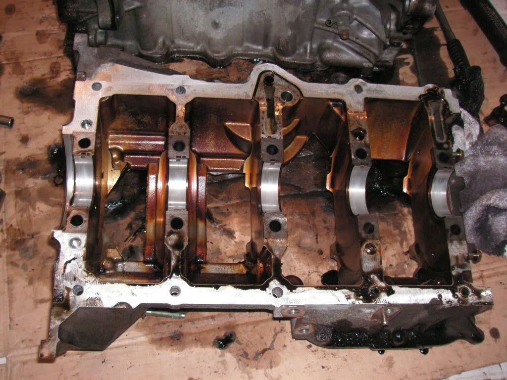

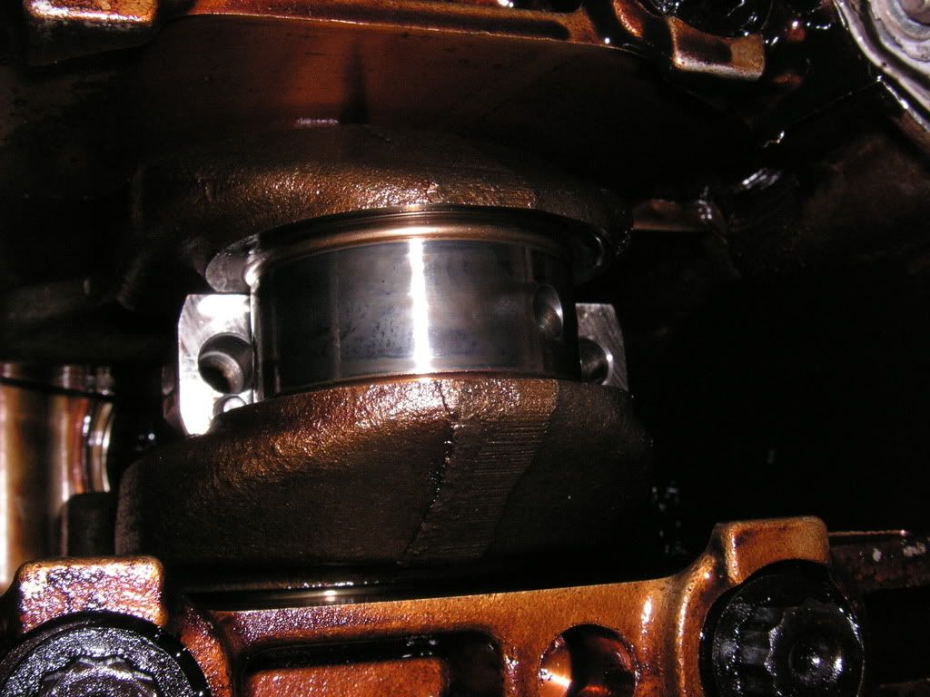

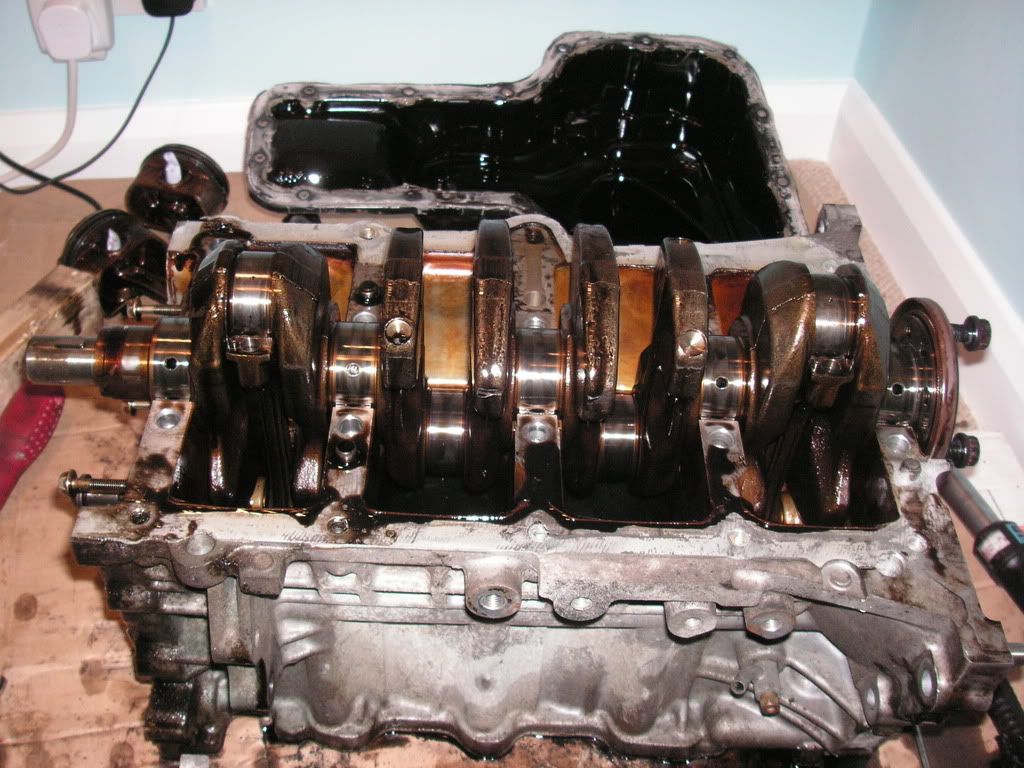

Bottom of the block with the bearing cradle frame removed. Crank bearing surfaces look OK but not cleaned properly so hard to tell for sure.

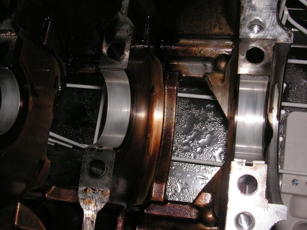

Bearing cradle. Bearings actually look fine....strange.
Close up of bearing cradle bearings

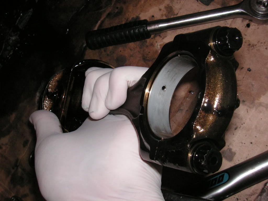

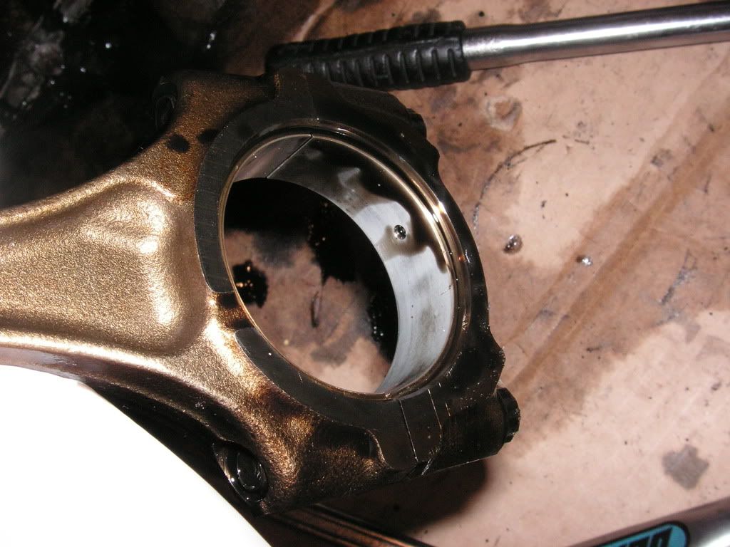

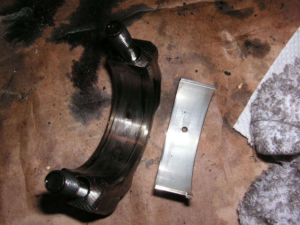

Con-rod cap with bearing shell removed. Again bearings look OK - maybe a bit glazed over.
Con-rod cap removed and looking at crank big end.
Looking at another con-rod from both sides
Close up of bearing cradle bearings with cradle about to go through dishwasher....the alkaline surfactant in dishwasher tablets is perfect for cleaning engines...

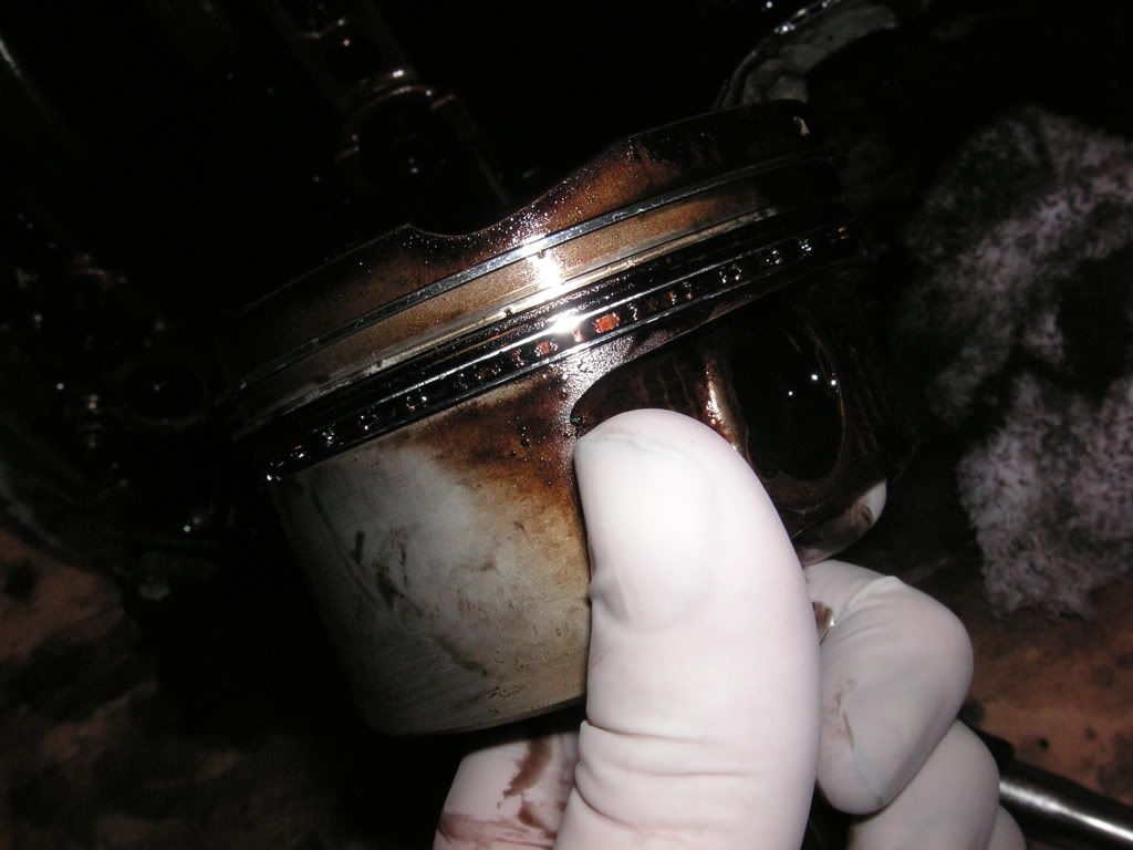

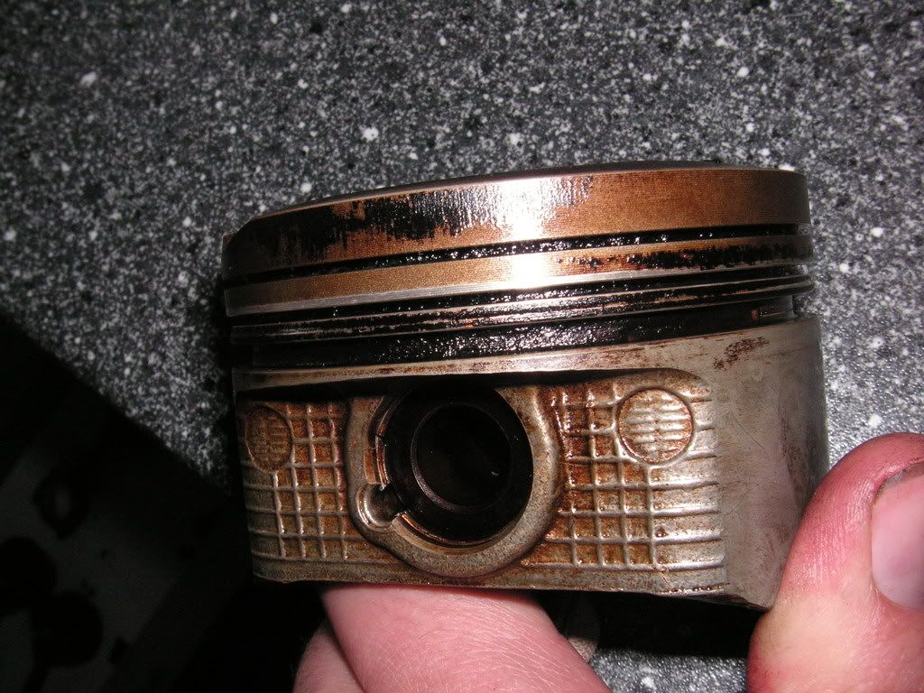

Close up of piston with rings in
...and removed. You can see the varnsh / gum / tar mixture that binded the rings up and caused oil usage
Nearly finished cleaning stuff up. To be continued soon.....

Quote from: "sjspitz"...and removed. You can see the varnsh / gum / tar mixture that binded the rings up and caused oil usage
A prime demonstration of why a good synthetic is a good idea. I have never seen so much gunk on the inside of an engine owned by me. Having said that, I have seen a lot more on engines owned by others that I have rebuilt. Could it bet that the famous precat failure is caused by gummed oil control rings?
