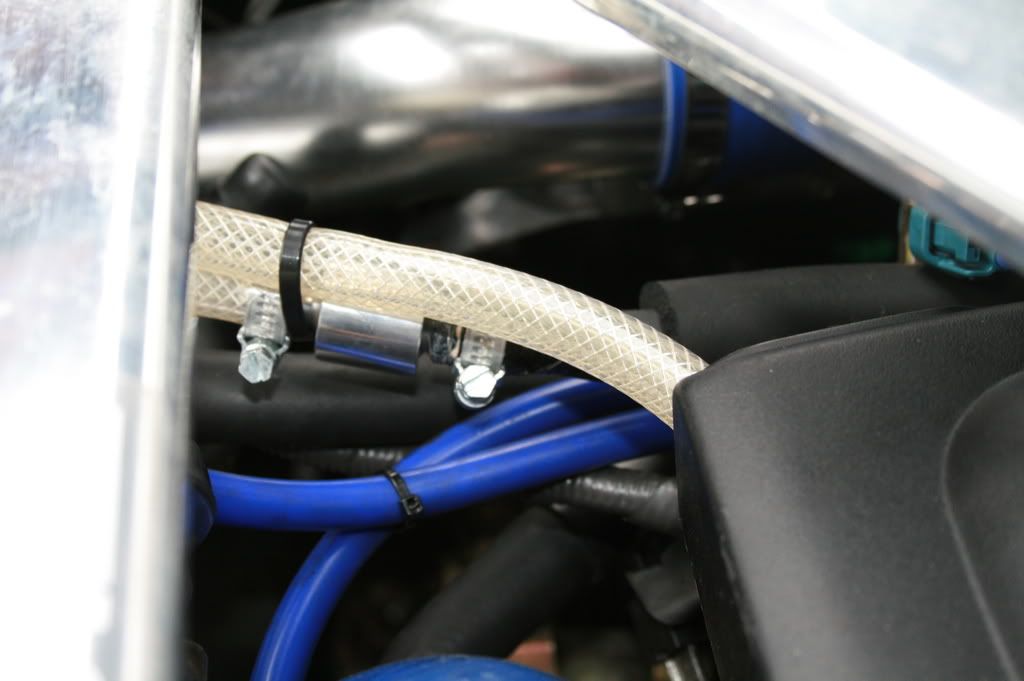

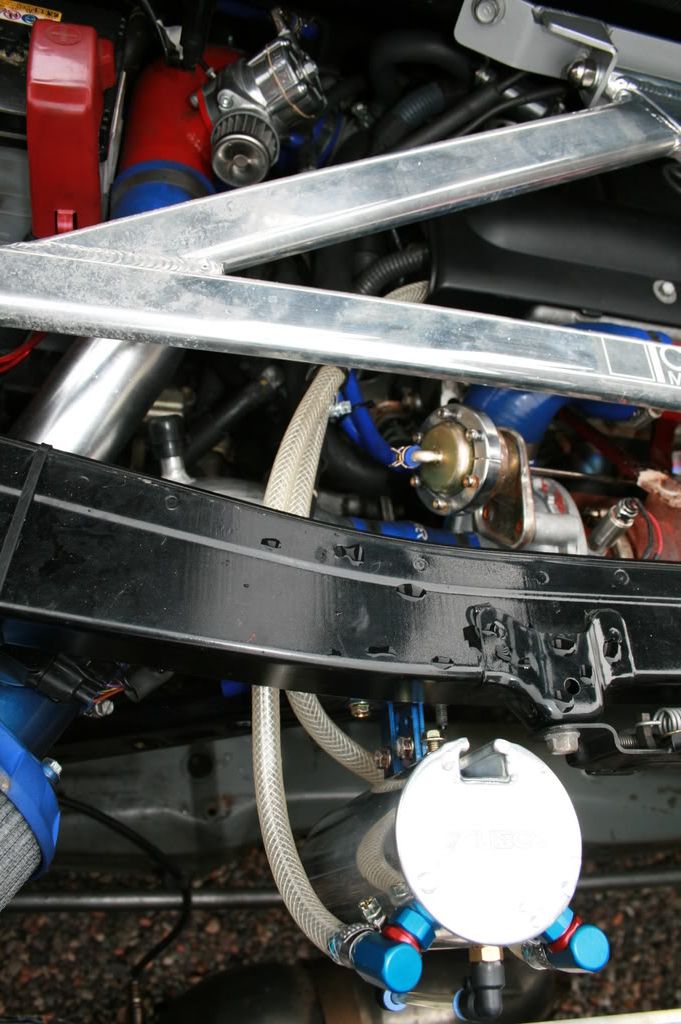

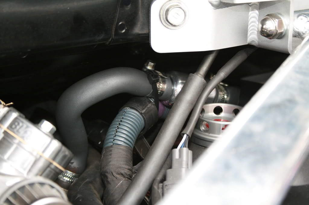

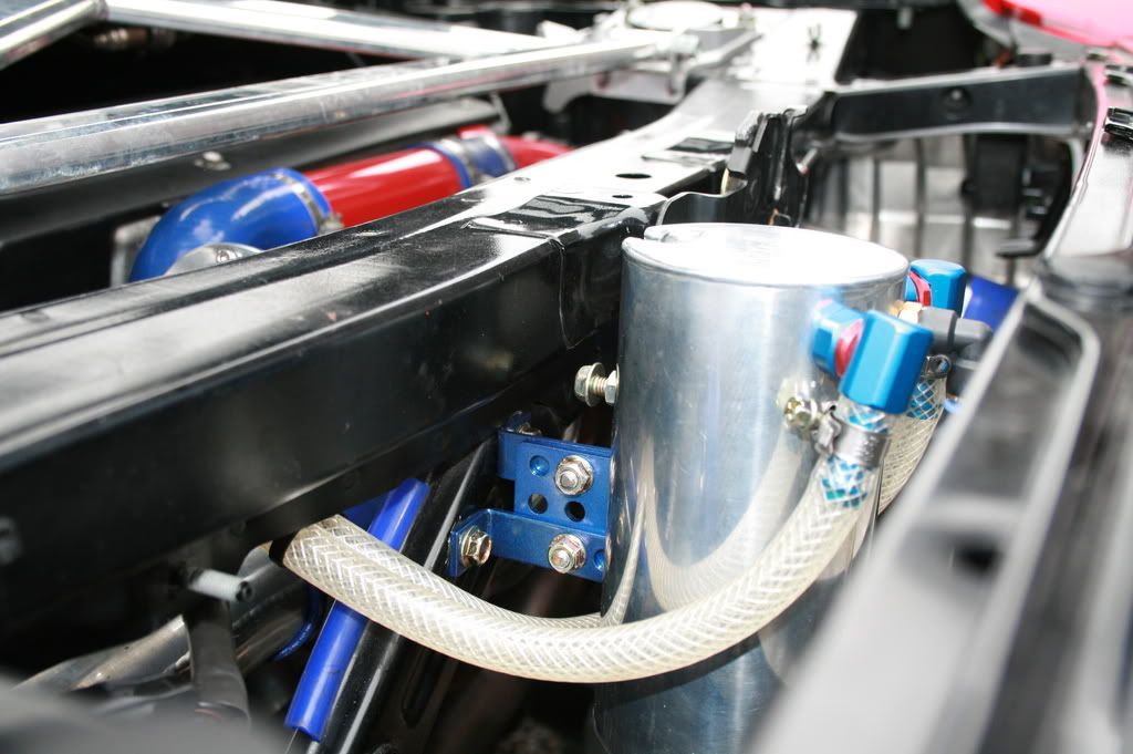

I have mine like this....
Large KV is "inline" between throttke body and breather... nothing is vented to atmosphere, all is connected as designed and works fine for me.
For the small one and catch tank.... PCV - Catch tank - KV - Inlet Manifold
