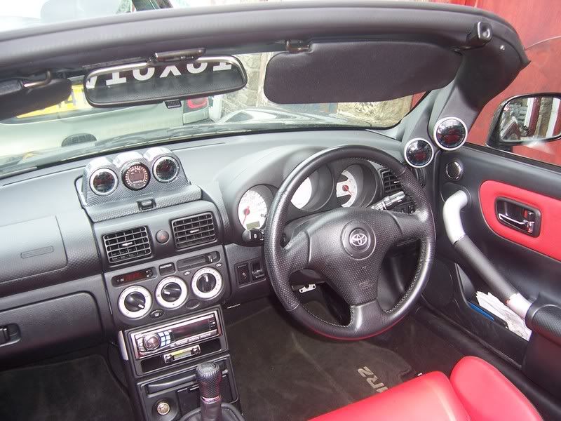

I have found this, which looks like everything i woud need to instal my single din unit? Ie i dont need any more interior trims?
 m http://www.ebay.co.uk/itm/Toyota-MR2-Ro ... 25654743d1 m
I think you still need the fascia
VVT-i
What I would refer to as the facia is included in the link above, which is the part with the pocket/tray, also included is the ariel adapter and the toyota ISO lead.
To make thins look stock and fit better. you would need what I would refer to as the surround trim, which Russ has posted in the photo above (top piece in the picture) however, the one in the picture is different from mine... facelift model, maybe the one pictured is from a pre-facelift?.. Russ?... which would explain why a facelift surround trim is needed to make it all fit properly and look stock.
The trim surround is the same as what goes around the ashtray too.

So i brought the kit from the ebay link i posted above and got it through the post today (3 days) for 14 buckaros...
Bit of messing about to fit but very easy as it came with a detailed fitting instructions for the specific car! this was a great help and i can only give a very positive feedback on the kit itself.
It came with - facia, wite harness/adaptor and arial adaptor (not required) with instruction booklet.

Mine looks exactly the same as the one pictured above completed, my car is a W reg (2000).
