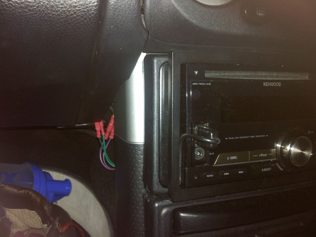

No, just as you see in the pic.
Now, obviously, there's some cosmetic adjustments to be made, but I can get a surround plate made by the engineers at work.
I'm just happy to have the thing in situ.

Rinzleristron
If you have the original double din size factory fitted fascia you can re-use that and just get one of these (it fits the Roadster too):-
 m http://www.dynamicsounds.co.uk/autolead ... -3039.html m
It might save you having to make something custom. All you would need to do is ditch the cage that came with the stereo, and fit the above fascia mounts to the side of the new headunit and the factory fitted fascia will fit around those

iPap
Why are they not fitted flush?
My Pioneer sits flush, I'll try and find a picture

CJW
Quote from: "iPap"Why are they not fitted flush?
Because the side brackets aren't adjustable to allow it to sit further back?
onion86
Same thing I was thinking, looks pretty awful, even with those extra side bits to make it look 'better'  s:? :? s:?
