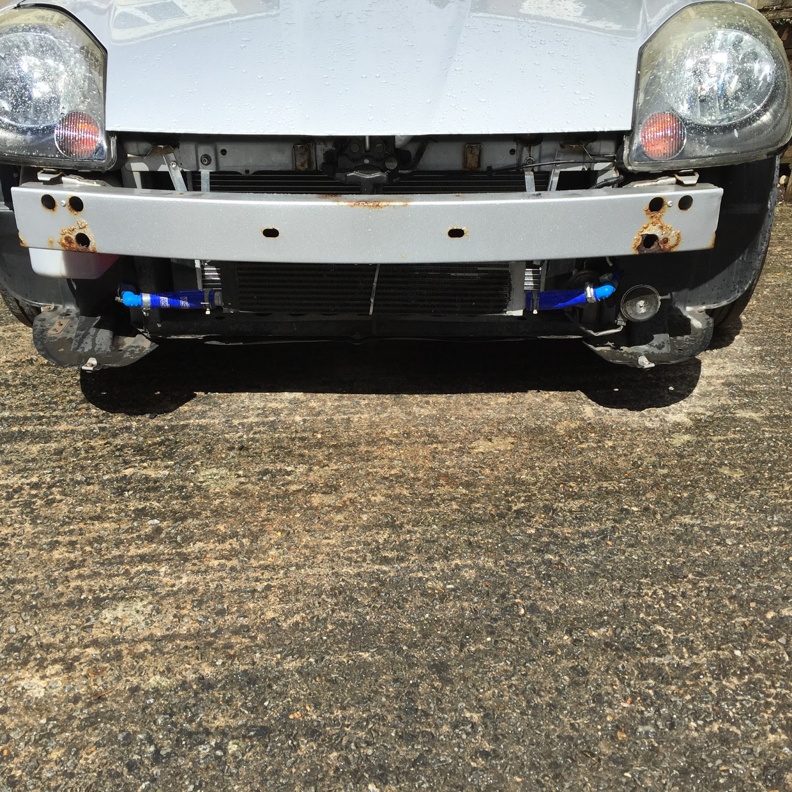

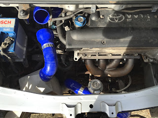

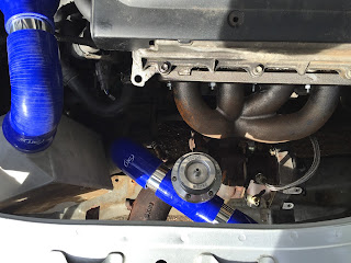

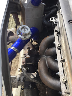

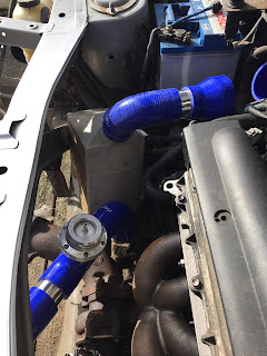

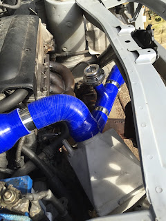

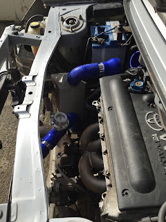

first mock up of turbo /  chargecooler plumbing
final spec will be
r33 gtst ball bearing turbo
ebay cast t3 manifold
sports cat
single silencer with bumper outlet for tailpipe
ebay sandwich plate for oil feed
pace chargecooler
forge dumpvalve
AEM wideband with gauge
Greddy emanage ultimate with pressure sensor
MWR 630 injectors (thanks MattPerformance)
ACT Clutch
ultimate shifter bushes
PU strengthened engine mounts
Hardtop
Facelift front bracing
Matts chassis brace
KYB shocks with tein springs
Rota Grid 17x9 rear, 17x8 front
Braided brake hoses and rebuilt calipers with decent fluid
odb2 bluetooth adaptor with android tablet for torque and racingmeter pro apps

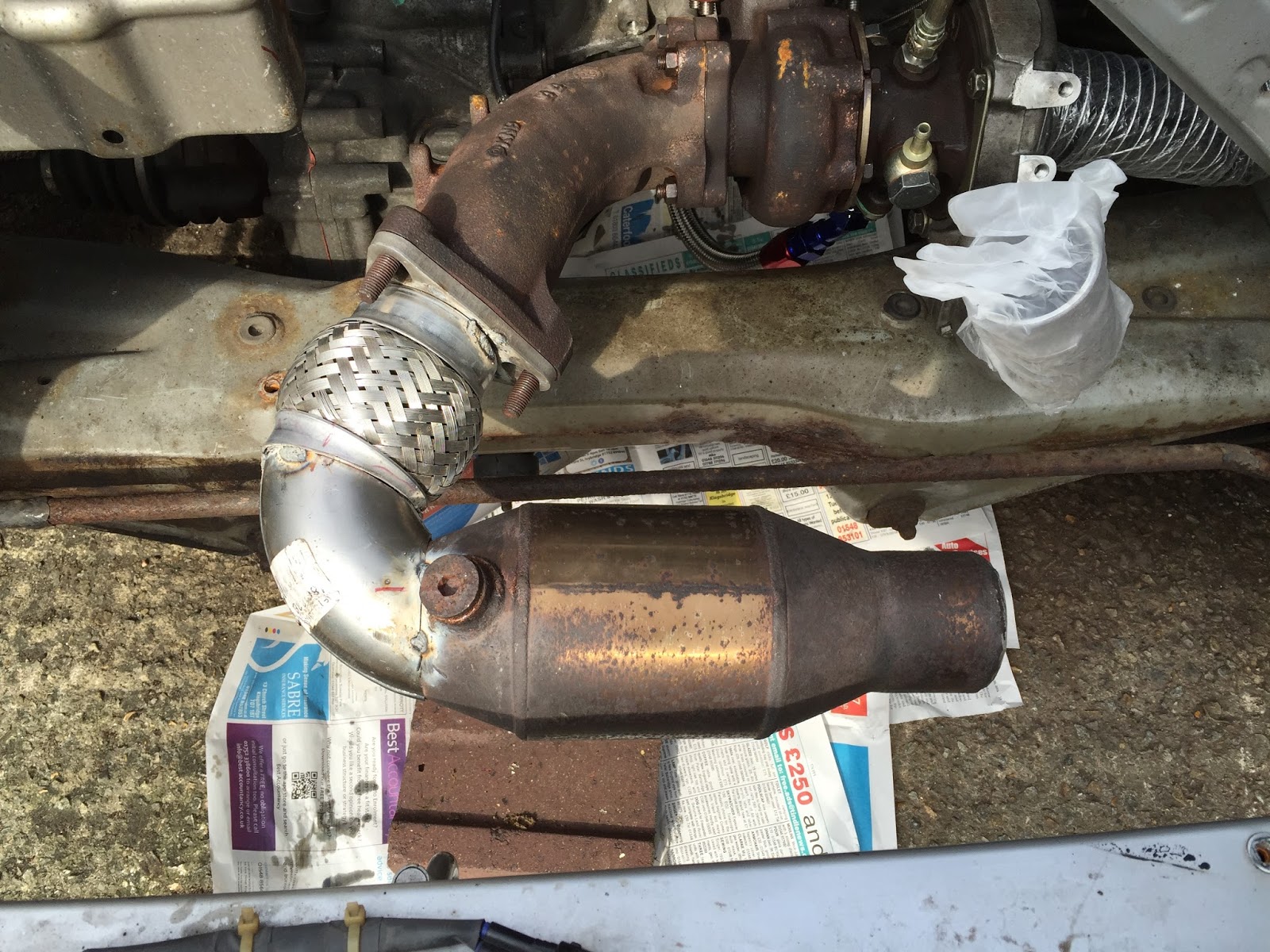

keljon
tacked the flexi and sports cat ready for final welding

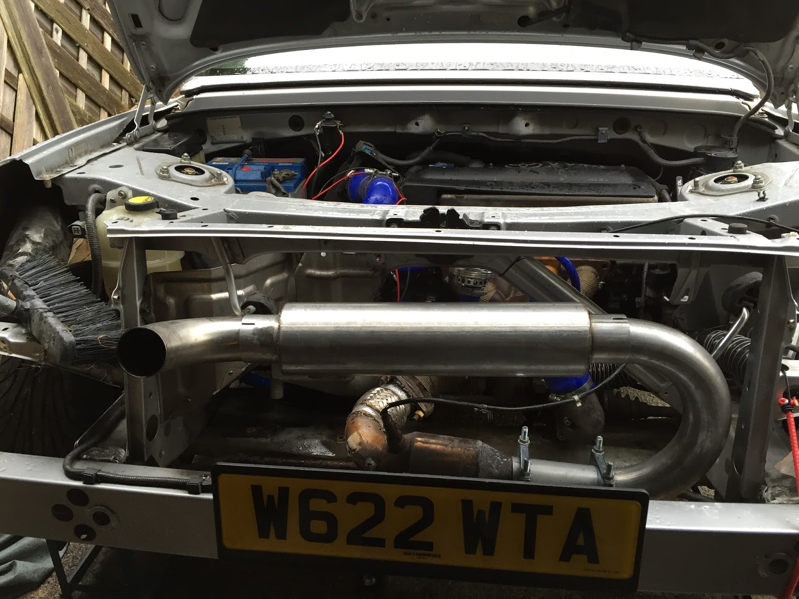

keljon
most of it done now, just waiting for some small parts to arrive
most of the plumbing is done
air filter installed under rear light
exhaust mocked up
bumper exit

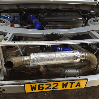

keljon
glass wrapped the silencer and anything near the bumper to (hopefully!!!) stop it melting
emanage ultimate is wired in and working after tracking down a wiring problem, spent ages trying to figure out why the idle was high, i have a bigger maf tube so figured it could be that so tested with the original part, swapped out my o2 sensor (i have both manifold sensor plugs running off one sensor) checked about 10 times for vacuum leaks and in the end concluded it has to be the IAC valve so stripped it all down and yeah seized solid, cleaned and reassembled and idle is perfect when warm at 800rpm
took it for a quick drive and turbo looks to be a really good choice as spools up around 2.5k so should make a really responsive car, clutch is slipping (i have a new one to fit but was hoping i might get away with the standard one on stock boost lol)

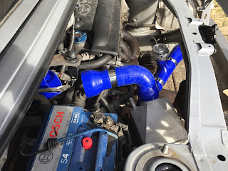

keljon
new clutch fitted
modified the engine mounts while it was all in bits
also fitted an AEM wideband as the innovate one i had was giving me some odd readings
