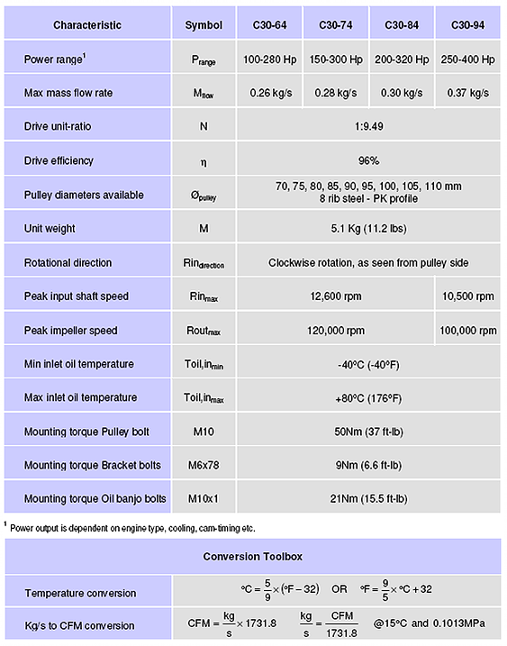

A Rotrex C30-94 and accessories has been ordered.
Spec below.
