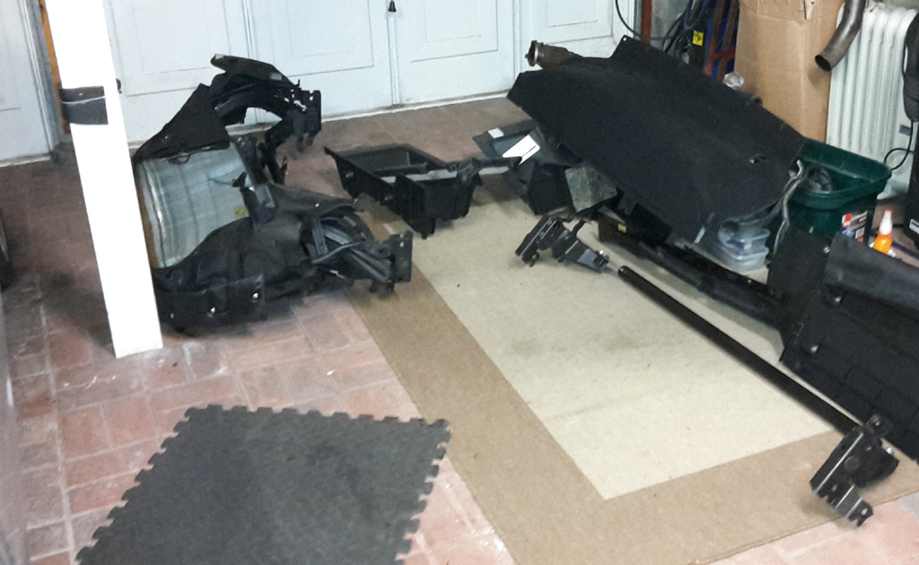

Ok as I run a hardtop all the time (unless a very rare top off day) I decided there was no point carting the heavy old folded down softop around with me so stripped it out last night, took just over an hour to get to the point in below pictures, nothing too difficult apart from awkwardness of lifting it out on my own once the zillon fixings were removed, but I managed.
I watched the following video to get an idea on what is involved, its not a perfect guide but helpful and does give you the pointers on where the fixings are etc - https://www.youtube.com/watch?v=BzRfPC00qc8
Here is a pile of parts removed :) , I will be refitting the lower part of bins and the back carpet/cover which on quick mockup looks pretty tidy, just a little work to do at edges to cover exposed metal but I think I can utilise the drain pockets and things to make it look ok and will get some pics up once I get it back together.
I also have a brace/harness bar to fit in which you can see in pictures, I pulled this out of the car I stripped turbo off down at Rogue on the weekend as its saves me making one after hacking up my softtop frame apart to get the seatbelt mounting parts (something you need to do if removing softop as mounts are part of frame). Its made up of hacked softtop frame ends and a custom made bar going across which looks good and strong.
Initially I did think the removed top might be of use for someone but probably not now so if anyone is planning same and doesn't want to hack up there frame I will be cutting mine up to get brackets for seatbelt if you need them.
m1tch
Remember to keep the cross bar and modify the softtop frame mounts to allow you to run OEM seatbelts.

Quote from: m1tch on October  1, 2019, 12:15Remember to keep the cross bar and modify the softtop frame mounts to allow you to run OEM seatbelts.
Yes thats all in hand see above :)  i picked up a harness bar from Rogue which is made up from a cut roof frame with belt mounts and a strong bar between them :D
I actually don't have the cross bar anymore and I can't really tell the difference. Not having it also improves the accessibility of the newly created cargo space!

Looks neat Snelbaard :)  Personally I think the car needs the cross brace to maintain rigidity but I guess with hardtop not so critical, I will fit the one I have as it will double up as harness bar once I get some better seats that can take a harness.
I ordered some black carpet from ebay today so hopefully get it all finished off and buttoned back up in next few days, I washed out the drain pockets tonight to make sure they are clean don't start to stink.
