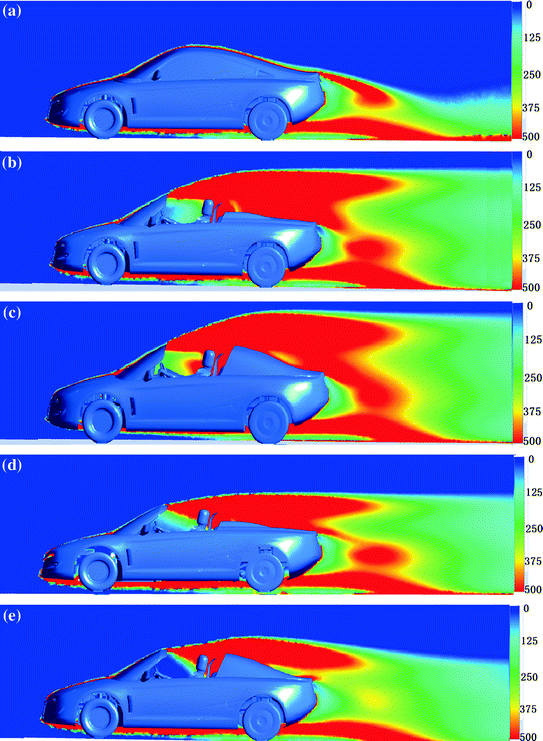

I plan to add a rear lip at some point too, but not sure how it will work on a car without a roof (or windscreen!)...
From what I can tell, there is separation on a standard car as air flows over the roof (image below). Notice how the rear window doesn't clear of water droplets when driving along first thing in the morning? There's no / very little moving air there to blow it off!
The air basically gets punched up by the front of the screen, skims the roof a bit, then off into the ether.
So, two things, when you have a roof:
1) Any rear wing needs to be up pretty high to be within any significant area of flow, for it to be effective.
2) However (can't find the documentation / reference now), adding a little lip to the boot lit can improve the effectiveness of the rear wing. My sketchy memory of this is that air builds up against the lip, leaving a stagnant region which increases the thickness of the boundary layer all the way along the boot lid to the base of the rear window. This has effectively 'filled in' that region, so the air can stay 'stuck' to the rear window better - making that blue region in the image above thinner, and the yellow area closer to the boot lid, so a wing doesn't have to be as tall to work effectively.
However, the study was on some sort of front engined car, so this may not work at all once you start adding vents. In the MR2's case, using a small lip to attempt to build a thicker boundary layer on the rear lid may end up reducing cooling and have air 'spilling' down into the vents. Either way, this document gave me a clue as to how counter-intuitive aerodynamics can be, and how little I know about it!
Leaving the screen on and removing the roof puts all this to pot again, with the wing having to be REALLY high to get into any sort of useful airflow. Obviously the image below isn't an MR2, but it also handily illustrates just how changing the angle of the roof / rear window can maintain flow separation over it - meaning you don't need a huge wing. Wonder if this is where the term 'fastback' came from?
I've seen data that suggests removing the roof can add up to 25% drag in some cases!
Removing the screen and roof completely? I don't really know what that will do. My initial guess was that removing the windscreen probably turns the whole passenger compartment into a large low pressure region, increasing both drag and lift. However, I then saw this... which is basically an extreme version of what I currently have. It appears a bigger 'lip' - probably in front of, but maybe also behind the cooling duct according to an article I just read - may even be enough to shoot air completely over the cockpit!

Quote from: AdamR28 on November 30, 2020, 15:05So, two things, when you have a roof:
Most cars, incl. the MR2 roof up, are roughly airfoil shaped with the longer side up.
The airflow is indeed turbulent behind the cabin but also flows downwards. Also, even the turbulent air flows to the rear over the lid. As such the wing indeed sits in more lamina flow the higher it sits relative to the roof but it does not have to be as high as the roof.
Roofless it will still sit in an airflow, just not only laminar, so it will still have negative lift and even direct the airflow.
The lip on the rear of the deck on it´s own primairily provides a tear off ridge.
Under a wing though it also raises the speed under that wing thus increasing the airfoil effect.
As the rear wings can be found at silly low prices I´d say you could simply try.
Now, with a roof, even just a windscreen the so called 3D makes sense but in your case it does not so simple straight will do better.

Lest it becomes the next urban myth; on cars negative lift of the airfoil and drag increase are nót necessarily directly related.
