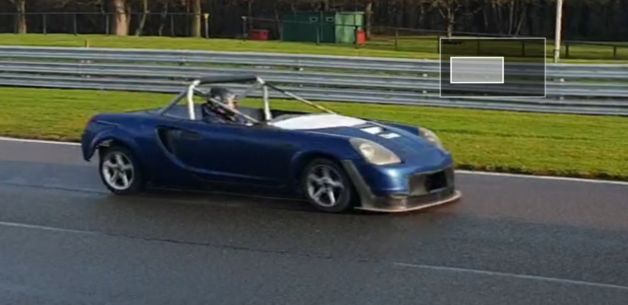

Here's a still from a video I took of Maurici heading past the pits... not on the brakes at this point, and the front of the car looks very low! There's also a lot of 'squirt' coming off the front corners of the car, and a reasonable amount of spray being sucked up into the air, as shown by the water.

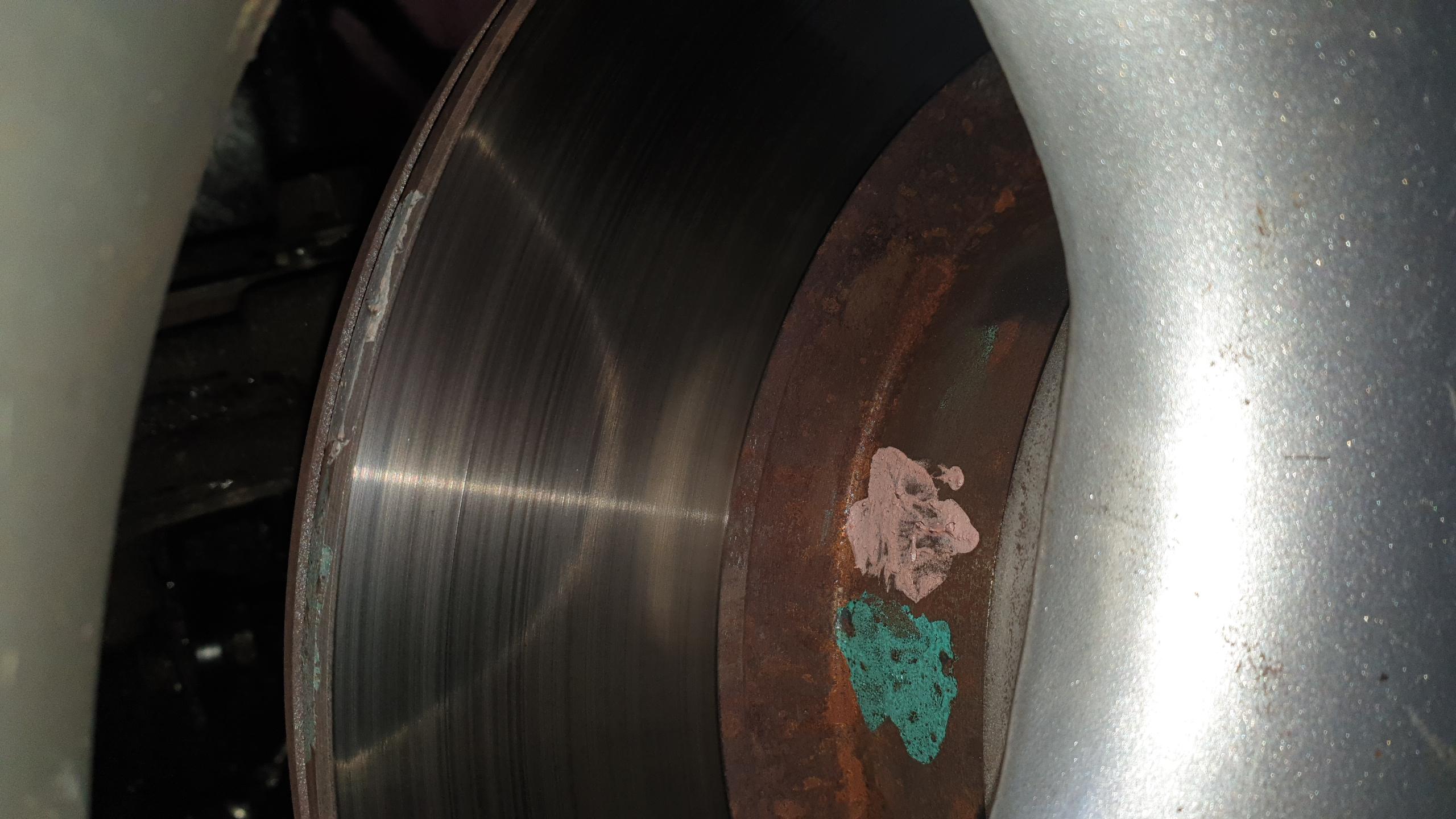

A quick check around the car revealed that everything was still stuck on, I had burned about 200ml of oil (haha), next to bugger all fuel (started with nearly a full tank) and the brakes were getting to surprisingly high temps.

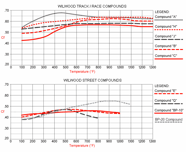

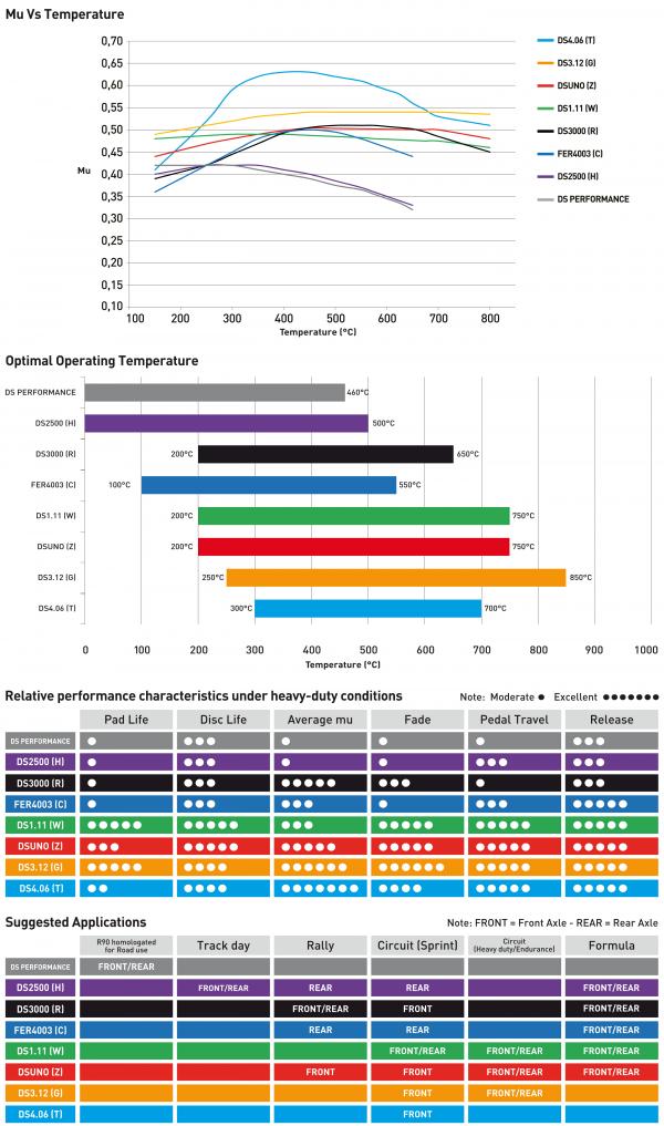

Front brakes: The green paint burns off at 500 degrees, the pink at 600.
Rear brakes:

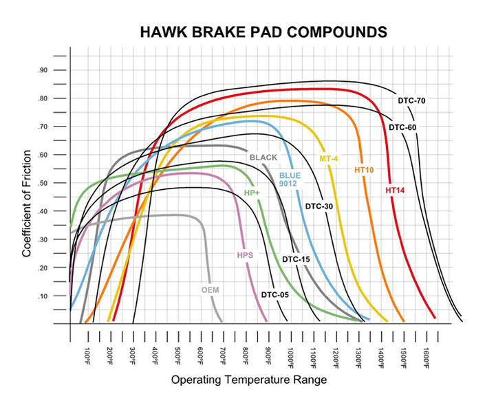

I've said it before, but I'll say it again – these are Apec pads. Cheapo road pads from the local motor factor - you can do a complete car for under £40 – yet they work really, really well. 600 degrees is a fairly significant amount of brake temp, just have a look at what 'proper' brake pads are rated to.
(For reference, 500'C = 930'F, 600'C = 1110'F)
I'm unsure how well the Apecs will hang on when it's properly dry and I'm really pushing on, but I've never had these fade on me (other than 'green fade' when bedding in, of course) and have done plenty of track days and racing with them fitted to heavier cars with smaller brakes. They just tend to wear faster if they do get too hot, which produces tapered wear, and associated mushy brake pedal – which is enough warning to change them. A spare set in the van, changed over in ~10 minutes, job done.

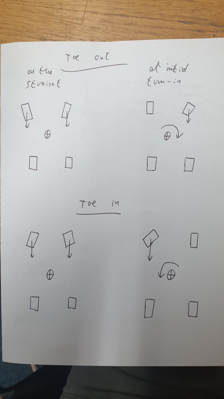

Speaking of – Maurici took the car out, got settled in the first lap, tried to push on a bit the second, stuck it sideways a lot, then came straight back in and declared it was too much of a handful for him. He is one of the people I would say knows how to handle a car – and the video below proves it (see 3:50 and 4:55 for proof) – so for him to agree with me that the balance wasn't there meant I should probably try and do something about it!
I went for the simple options: more pressure in the front tyres, and a bit of toe in up front. With hindsight, I could have disconnected the rear ARB as well / instead, but for now lets explain what I did do.
With the fraction of static toe out the car had initially, this means the inside front wheel creates scrub at initial turn in, resulting in an oversteer torque on the car. Changing that to toe in, means the torque on the car is then trying to make it understeer, settling down the initial phase of the corner.
I feel a diagram would be useful here...
The cross in the circle represents the centre of mass of the car, the point around which all forces operate. The arrows represent forces – straight ones are scrub due to the tyre pointing in a different direction to the car's motion, curved ones are the resulting rotation.
Now, the MR2 uses almost 100% Ackerman steering, meaning the inside front wheel turns more than the outside (for the same amount of steering lock). So when combined with toe out, this effect is magnified. With slight static toe in, this reduces the above effect at the very start of the turn-in phase, helping to keep the car settled.

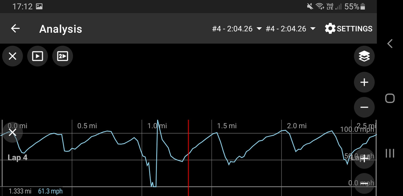

Here's a sketch of some data traces I did from memory / feel, because the datalogger wasn't running, obviously.
(Bugger, forgot to send these over to myself last night - will upload at another point!)
This is Munter (in the bone dry on proper tyres) vs MunteR2. The main things that stick out are:
- The wet bits of track really cause a huge drop in apex speed - 20mph through Island bend!
- MunteR2 is clearly a lot faster in a straight line, gaining around a second on each straight, and a huge gap in the drag up Clay Hill.

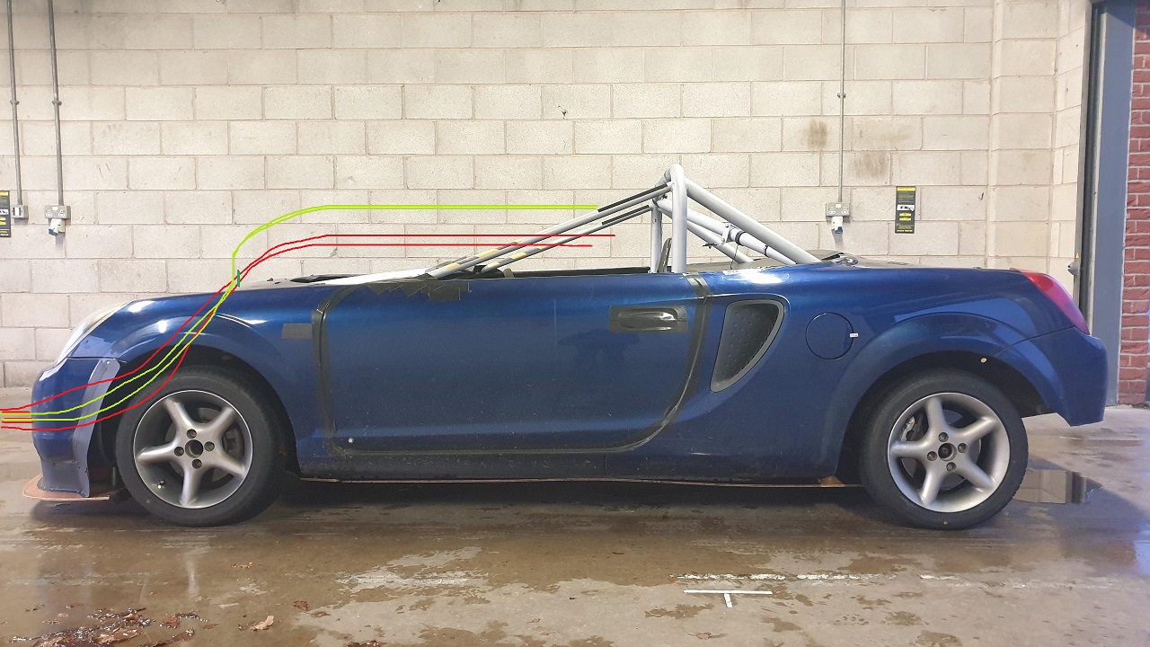

- Sort the aero balance. This was perhaps the first thing that struck me as 'awkward' about the car, and certainly Maurici agreed! Big Gay Wings (BGWs) are not really my style, and they do cause additional drag, so that leads me to playing with the floor...
My recent aerodynamics research revealed that there can be some significant gains from a proper diffuser. At the moment it doesn't have enough angle, and there will be air spilling in from the sides (high pressure down the sides of the car vs low pressure under the car = the air tries to go from an area of high to low pressure, reducing whatever effect it is having).
So I had a nosey for some documents which may assist with design, and stumbled across this absolute gem: https://www.racetechmag.com/2017/08/willem-toet-explains-motorsport-diffusers/
This gives me pretty much all the info I need to get designing and (hopefully) create something that will create downforce.

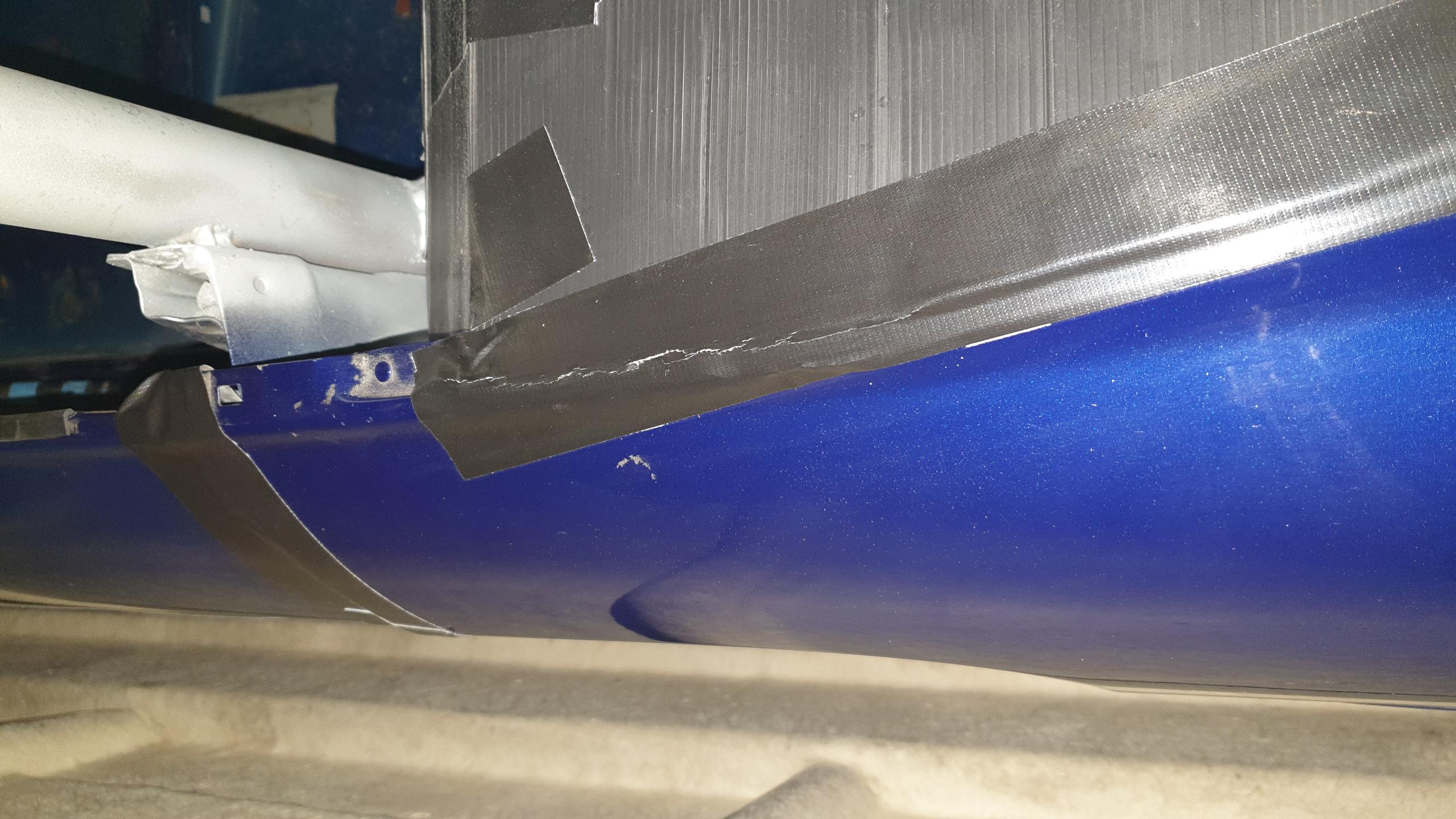

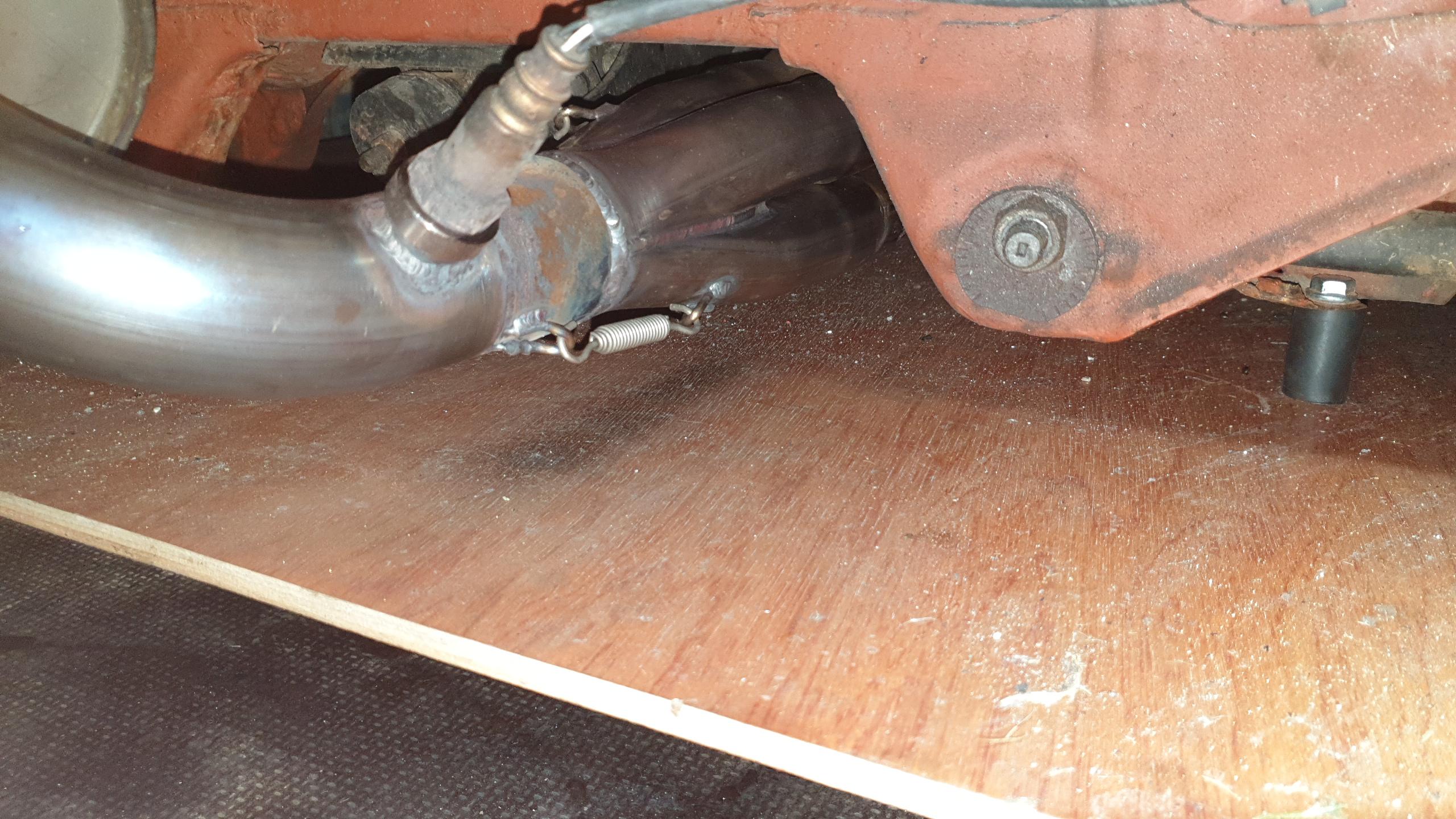

I do need to be a little careful of the exhaust proximity to the floor though, as shown it below it was slightly affected at the weekend...
As part of this job, I will raise the front of the floor by 10mm or so. This will reduce front downforce but therefore aid balance at higher speeds. Plus, it will help to stop it bottoming (especially once a passenger is in!). It was only the deflectors in front of the front wheels, but having them scrubbing as I hit a bump while braking on the way into Island, and all the way through Shell when the car is fully loaded up, was a little off-putting. If that still doesn't work, I can pack the bump stops or fit longer or stiffer ones.
Playing with ground effect in this way, especially with soft suspension, I'll have to be a little careful not to go too 'extreme' else a change in ride height can totally cock up any downforce – eg. hitting a big bump mid corner could stall the rear diffuser and lose grip... (IF any of it works!)

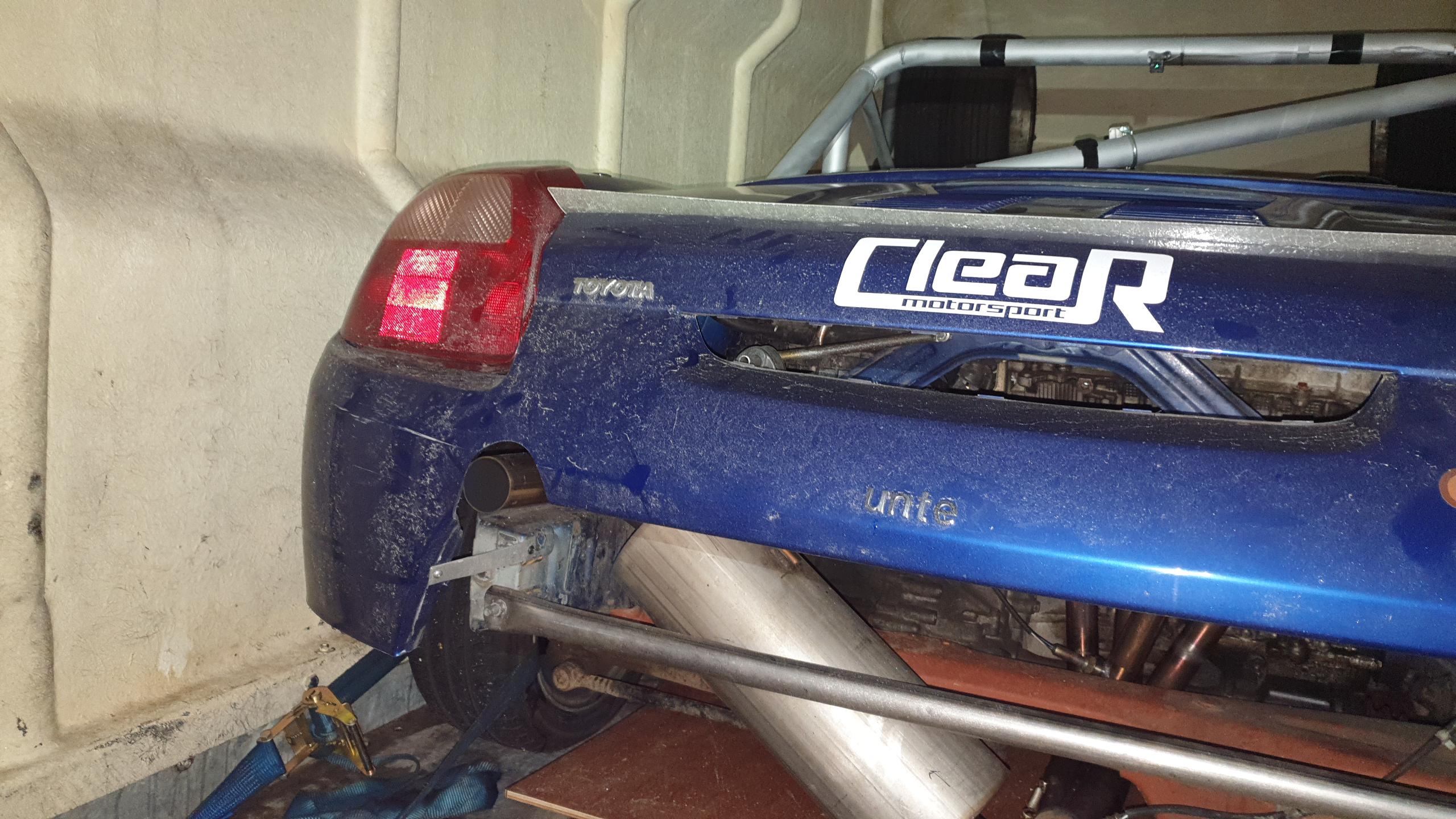

Another note on this subject, the rear of the car has a really 'turbulent' look about the dirt on it. I am wondering if the floor exit being 'in front of' the rear of the car hasn't helped in this respect, so extending the floor into a diffuser and having it exiting behind the bumper should help.

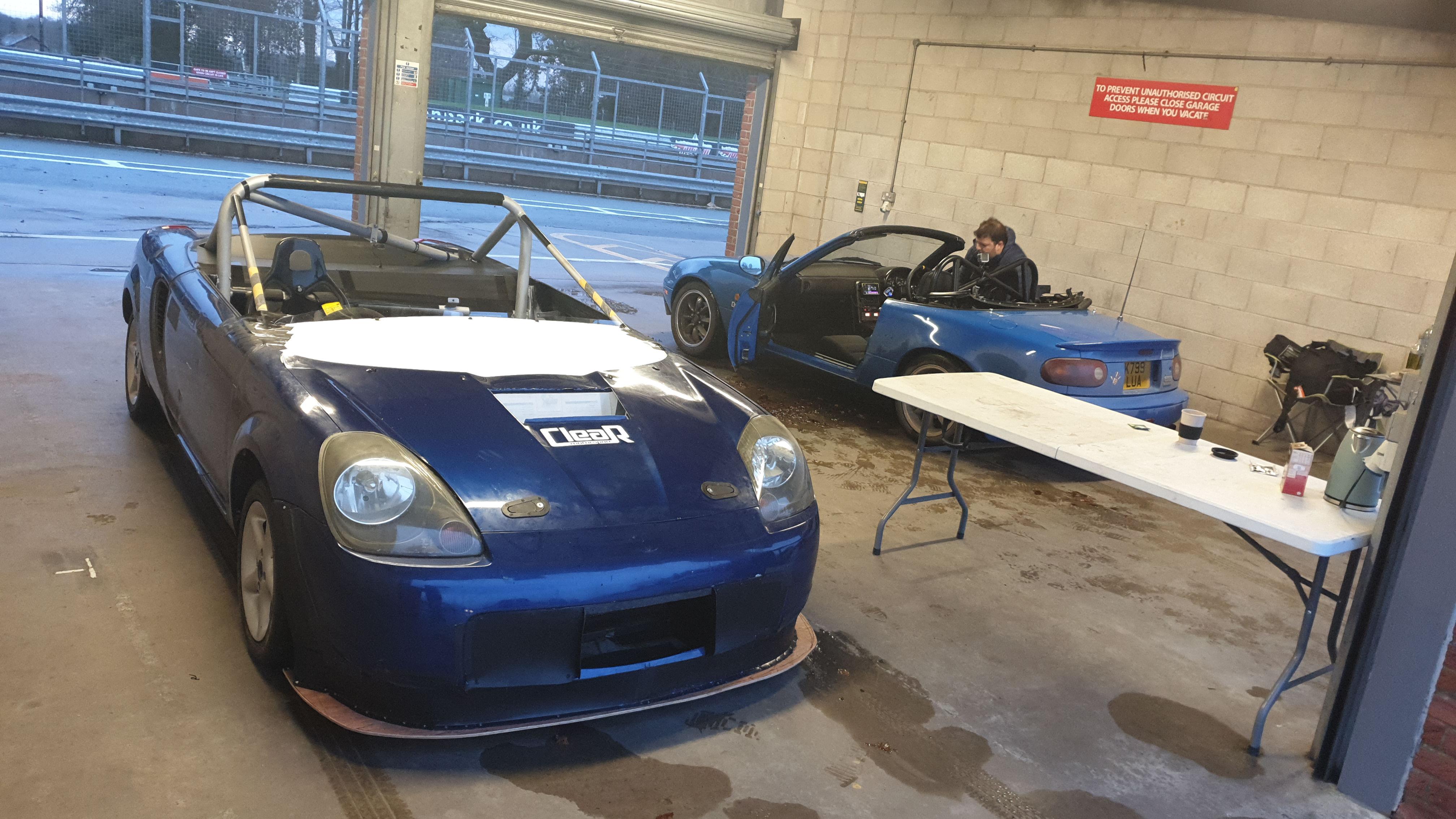

- Attempt to keep air out of the passenger compartment. Now this is a funny one which confused me at first. The panel behind the seat, which is designed to keep air out from the area where the roof would normally bolt (which would end up like a parachute), is held in with gaffer tape as before. This time though, the gaffer tape has started to rip, indicating it's taking a fair amount of force...
With more thought this makes sense: 1) the levels of the front and rear openings to the cockpit on the MR2 are totally different to the MX5 – the MX5 has a higher front and a lower rear, the MR2 is the other way round.
2) I'm now firing a heck of a lot more air over the scuttle thanks to that big duct from the front bumper through the radiator. This has to go somewhere – and it appears that is into the cockpit and thus into that rear panel.
I'm thinking of some sort of additional deflector mounted to the bonnet, firing the ducted air up, sideways, or a combination of both. Needs more thought.
On that note, the bonnet – despite being single-skinned and pretty floppy – barely bobs around at all even at 100mph+, which proves there Is very little air entering the front of the car. Happy days.

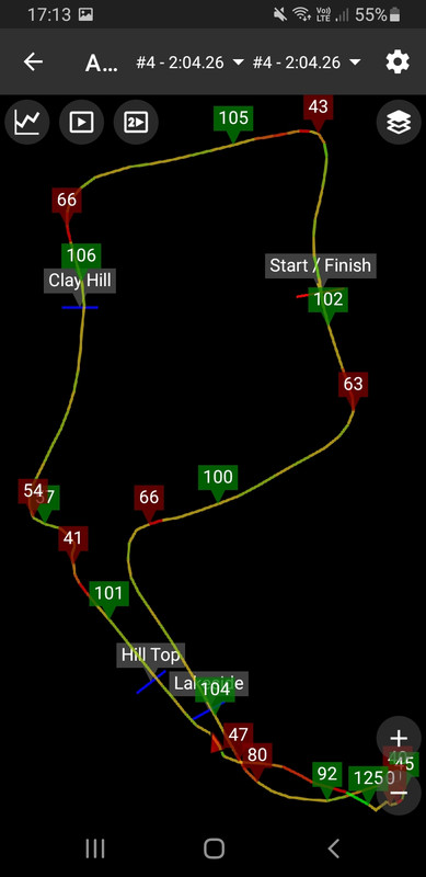

Got the datalogger info now:
This is Munter (Blue trace - in the bone dry on proper tyres) vs MunteR2 (red trace, session at the end of the video). The main things that stick out are:
- The wet bits of track really cause a huge drop in apex speed - 20mph through Island bend! (Around 4300 feet, looking along the bottom of the image - where I have plonked the white vertical line). At this point, looking down the far left of the image, you can then see that the red trace (MunteR2) is pulling 0.86 lateral g, and the blue trace (original Munter) is pulling 1.17g. We can assume that they are taking the same radius, therefore this explains the difference in apex speed - 76.8 vs 96.6mph. Heading right down the bottom, at this point in the lap the red trace is 1.454s behind the blue one, and this steadily climbs through the lap. This is called the lap delta.
- MunteR2 is clearly a lot faster in a straight line, gaining around a second on each straight from looking at the delta (the red line drops down slightly as it goes along), and a huge speed gap in the drag over Hilltop (7500 feet) and up Clay Hill (10000 feet along).
- Druids (11000 feet) is also really slow compared, because it stayed wet.
- Cascades (2300 feet) dried out sufficiently for corner speeds to be matched.
Looking into the data more, I drove a 2:07.8 'continuous' lap (from Shell Hairpin to Shell Hairpin), and the best theoretical (puts together all the best sectors) on the day was a 2:04.1.
So, with all said and done, I think this car is capable of a 2.00 minute lap in the dry, even in current guise.
And just for fun, here's 'old' Munter (Blue trace - chose this one because it was also dry) vs Lobster (Red trace, my Westfield with the bike engine, on silly skinny road tyres and with terrible aero, hence not really having higher apex speeds despite the low weight).
You can see the insane differences in acceleration from the angle of lines, which means massive differences in top speed - up to 25mph at points.
Another stark difference in the traces: With a low-powered car, the key is to maintain speed; so you brake later, rolling through the apex faster, and you can do this because you don't have all that excess power ready and waiting to spin up the rear wheels when you put your foot down.
The opposite of that is what I do in the Westfield - I am slowing down to minimum speed earlier, and in some cases a lower minimum speed, in order to get the car fully rotated earlier and take advantage of that extra acceleration, which is the optimum way to end up with a higher speed at the end of the straight.

Just looking at your speed graph and how smooth it is I can see you don't brake as hard as me, therefore carry more speed through the corners. Something i definitely need to learn.
Below you can see mine, lots of sharp drop offs where I'm braking to much. No idea what happend at shell, must have lost GPS.
This day/lap was in the middle of summer with temps around 25°,  roof off, on AR1's with bluestuff pads front, yellowstuff pads rear . Its actually the lap before the engine went pop 🙄

Right..... so has the flat undertray increased your front-end grip, or is it in combination with the splitter?
AdamR28
None of this is guaranteed, and slightly hard to figure out due to so many other changes, but here are my feelings...
- The splitter itself does next to nothing. I intended it that way. I didn't want something huge sticking out for both practical (eg. not smacking it on stuff) and cosmetic reasons.
- The floor, however, is a massive gain to both drag reduction and either generating downforce or reducing lift. I'm not sure if it actually *makes* downforce, but my gut feel is that it does, from how the car feels and that photo of it heading down the straight. It definitely reduces lift though.
This is explained well in the video below:
I think the MR2 is a perfectly-suited car for this modification, due to the engine location and lack of hot stuff running all the way down the underside of the car.

The front nappies will be doing a little bit of lift reduction yes, but their shape and stiffness isn't good enough to produce downforce.
At the rear... It's more a cover to keep spray out than anything.
Quote from: AdamR28 on December  9, 2020, 10:41I'm not sure if it actually *makes* downforce, but my gut feel is that it does, from how the car feels and that photo of it heading down the straight. It definitely reduces lift though.
The whole car is shaped like an airfoil and moving forward through air creates less air pressure above than under. This results in a force opposed to gravity. Call it anything you like. Lift is most common.
The air passing underneath the car is affected by several other aspects: The road surface, the pofile of the underside, how the frontal air is directed, how the air passing through the radiator is directed, how air is ´extracted´ at the rear or not, the rake of the car etc.
A flat underside will reduce turbulence under the car thus speed up the air flow thus deminish the airfoil effect. As the latter is most commonly called lift, the effect of the flat floor is most accurately dubbed negative lift.
Basically most things done to the underside are counteracting the airfoil effect, thus negating the lift.
Now take rake. Thát creates a pressure drop by increasing more volume towards the rear of the car and although the resulting force counteracts the lift, it is different from the airfoil effect and you could dub it downforce.
Seems semantics but it does help understand what is happening.
The air vents in the bonnet are tricky ones. Although they reduce the amount of air pushed under the car by the pressure wave in front, thus reducing pressure under the car, it also affects the two air flows, thus affecting the airfoil effect. This may go either way although the effect of less pressure under is most likely the greatest.
All in all an übercool subject imo and I reallyREALLY appreciate the illustrative emperical efforts by Adam.
@nappies that is both yes and no. Just look under the front: There is a gaping hole allowing the air passing through the front to go underneath the car. This is already a totally turbulent flow. Imo the rear nappies are foremostly intended to keep the noise down.
What Adam has done is create a vent abóve, allowing him to close, smoothen the bottom and thát makes a lot of difference.
As I write; übercool.

Quote from: JB21 on December  8, 2020, 17:28Just looking at your speed graph and how smooth it is I can see you don't brake as hard as me, therefore carry more speed through the corners. Something i definitely need to learn.
I am actually generally pretty poor in terms of finding maximum braking. Know all the theory, but struggle to put it into practice! I tried to be last of the late brakers at Donington at a race meeting once - ended up through the gravel a couple of times. It is something I'm aware of and working on, but I find having a small margin for error comforting, especially on a track day. There are lots of people who *can* brake later than me, but this isn't the full picture so I've spent my time learning / researching other phases of the corner.
You need accurate datalogging equipment to see the subtle differences in braking traces. Something that has an accelerometer rather than using GPS speed. In general though, braking as hard as the car will allow is always a good thing, with a caveat - the driver must have the car under full control at the entry phase of the corner.
Something else that makes a difference is the suspension setup. If you just literally stamp on the pedal, the brakes will lock in any car (well, perhaps not something with shedloads of downforce) because there's not enough vertical load on the front tyres yet to allow the tyre contact patch to create enough torque to overcome the braking torque from the pads / disc.
It therefore follows that a stiff car will allow you to get to full braking effort more quickly, because it transfers weight forwards more quickly.
With a moderately stiff car, you can get from full throttle to full braking in around 0.3-0.35s. With the MunteR2 being on a soft setup, this is going to be more like 0.5s. At 100mph, that means having to start braking nearly 10m earlier, and the shape of the speed trace will be more 'rounded' at the tops of the peaks. Once you're on the brakes fully though, the steepness of the speed trace is unaffected, and in some cases can remain steeper because the car will be less upset by bumps on a softer setup.
Getting to corner entry phase, coming OFF the brakes is very important. Jackie Stewart is quoted as saying it's the hardest thing to learn. Here you are aiming to actually steer the car using the brakes, rather than the steering wheel. Turning the steering wheel introduces a slip angle to the tyres, which creates scrub - the tyres pointing one way and the car travelling another. This scrub reduces your speed.
If you can 'hint' the car into the corner (using a very small steering input) and then use weight transfer - via the brakes on entry - to get / keep more weight onto the nose, this will increase grip at the front (and thus reducing grip at the rear) and the car will keep rotating into the corner, with very little steering lock on.
On this note, if you jump off the brakes just before you turn the car in, or as you are turning in, this releases weight - and therefore grip - from the front wheels, just when you need it. Understeer. Safe, but slow. So, releasing the brakes smoothly is really important. Again with accurate datalogging, you can see what's going on in this area.
The holy grail is zero steering lock, with the car physically rotating around its centre of mass all the way through the corner, rather than being steered through, as the brakes bleed off and the power feeds in just as smoothly. In reality, what's possible for mere mortals is a series of steering corrections all the way through, the car transitioning from 'steering' to 'oversteer' conditions (and hitting everywhere in between) while you shuffle the steering wheel and increase and decrease pressure on each of the pedals, depending on which phase of the corner you're in.
The start of the main video above, with all the slides, is me trying to hit that stage, but just overcooking it slightly. Too much oversteer is also slow, as we all know, because that scrub I talked about is there in vast quantities - but you have to get the car out of shape a little bit for it to get close to its potential.
It therefore follows that, to hunt for 'the holy grail', you need to be comfortable with the car moving about under you... And you also need to be able instigate that consistently, with control; rather than simply reacting to what the car is doing. Many people never reach this stage for the reasons I'm about to explain below.
It is really important to consider the car and the driver as one. Bolting go-faster bits to the car does make the "car & driver package" faster immediately, but the car is then harder to drive and the driver will never get as close to the potential of the car as they would had they learned in a soft car. If you have a car that is now 5% faster because of the latest go-faster bits, but the driver can only exploit 80% of that performance, it will end up slower than a standard car with 90% of the potential used.
