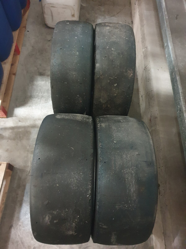

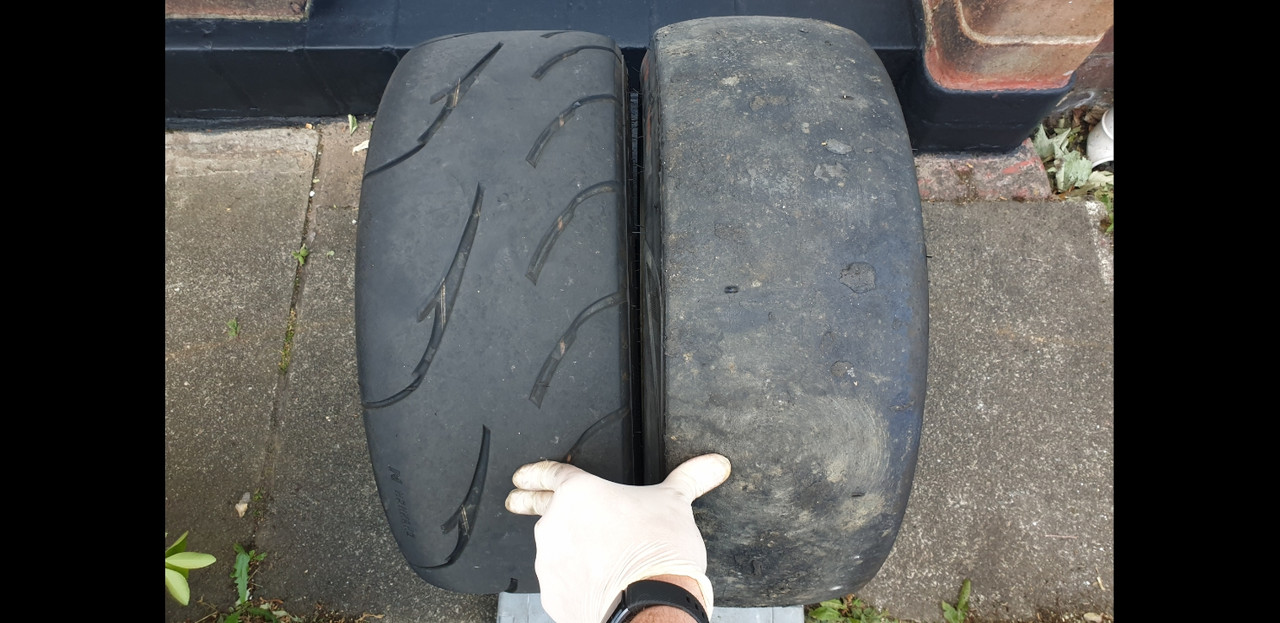

I use different size, brand and compound slicks on track. Not really to tune the handling of the car, but more of what was available on ebay at the time before a track day.
Fronts are 190/570/15 MRF slicks in hard compound.
Rears are 200/580/15 Hankook slicks in medium compound.
If you look at it from a handling POV  then my car 'should' be set up for understeer. In reality its a nice neutral set up. A hint of understeer maybe but this is what Toyota was going for with the car I think. The car is very manageable at the limit.
Both sets seem to heat up at the same time and have nice even temps across the tyres.
Picture below of the slicks compared to my AR1's. You notice the slicks are very similar in width even though the width numbers a different, especially the rears.
195/50/15 v 190/570/15
225/45/15 v 200/580/15
And the stagger of the slicks
