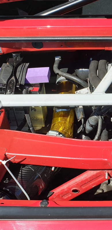

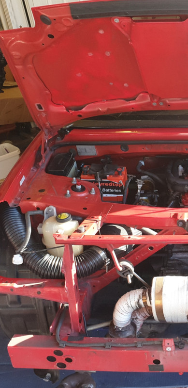

Current setup below. I can use the MAF pipe to go behind the battery and just fit a filter. I'll just need a straight silicone coupler to the TB.
As you can see there's a lot of pipework, which goes all the way to the NS side scoop.
With stock ecu always best to keep induction as close to standard as possible otherwise as with the 1ZZ you loose rather than gain.

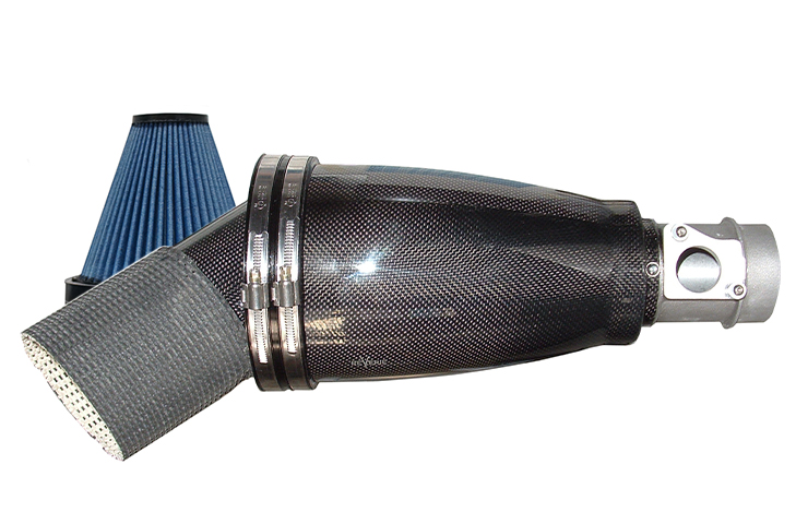

Lotus intake offering below, seems if I fit a straight coupler to the TB and run the BCM intake behind the battery its a similar concept.
https://www.reverie.ltd.uk/lotus-2zz-ge-engine-non-ducted-alloy-air-induction-kit-d230a/R01SE0276
Lotus intake
