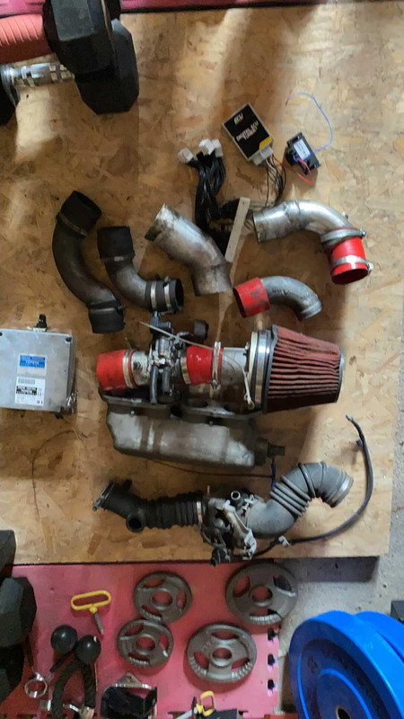

I've managed to source a Corolla 2ZZ compressor kit inc injectors, but I'm not sure what else will be required to make this fit to my Roadster. I'm currently using a 2ZZ Corolla ECU (89666-02091) which I'm led to believe runs the N/A and Compressor 2ZZ engine cars so that should fine.
Is there anything else that I will need like additional wiring, sensors etc or is it all just bolt on hardware?
Thanks in advance.

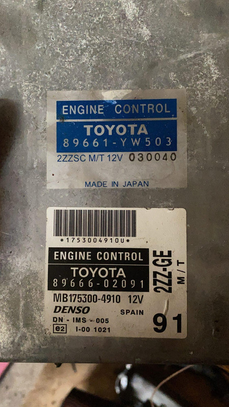

I find it hard to believe a stock 2zz ecu will run a compressor at least properly.
A standard 1ZZ ecu won't run a TTE turbo.
Can I ask what evidence there is to support this conclusion?

What ECU do you think runs a Corolla compressor from factory, standalone? Info on the ECU was taken from Corolla Club.
@rusty0273 would you be able to confirm the ECU part number your compressor is running?
Below taken from your thread: https://www.mr2roc.org/forum/index.php?topic=70018.msg834311#msg834311
Uses two ECUs - one from the original 1ZZ and one from a 2ZZ but I don't the details of which does what. Will take a few pics later and post up this evening or tomorrow. If you have a specific queries on it I'll try to answer.

From a quick Google the ecu part numbers are the same.
However the injectors are different 330 vs 440.
Confused dot com

Is that a DET3 piggyback in that picture?

Ecu mystery solved. Same 2ZZ part number but note the blue sticker...
