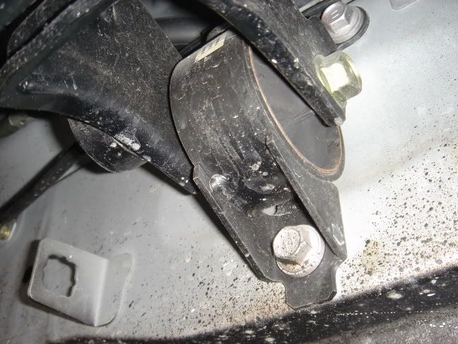

Front engine mount prior to insert installation.
My SMT has always been well maintained. I'm currently using TRD full synthetic engine oil, TRD oil and air filter, Redline MT-90 tranny oil, Toyota OEM engine coolant. I service my car every 5000km including routine inspection on my engine, brakes and clutch. With all my chassis braces and struts (TRD front+rear tower struts, corky's, TRD front+rear member braces, TTE sways), my car drives with pretty much responsiveness. Other than the occasional clutching slipping from 1st to 2nd during cold start, it's pretty much tip top. Clutch engagement is quick and responsive. I don't have the problems common with pre-2003 SMT ECU, where the clutch slips horribly. My clutch seldom slips. Like all other SMT owners, I never have any shudder of the car during gear engagement like the manual orr the grinding sound from 1st to 2nd gear. So prior to the insert installation, I'm pretty much doubtful as to how these inserts are gonna improve my ride....

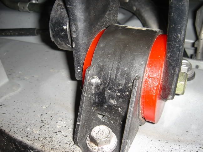

POST-INSTALLATION NOTE:[/u]
The installation took about 30 mins. All I can say is I can feel the change immediately....
So this is how it went :- I found out there's tremendous shudder during idle, and it got worse during 1st gear when the rpm was climbing to 1500. Passed that, and the shudder faded. Same thing happened when I reversed. The shudder was (and still is) unbearable. The vibration is so severe, it actually causes a low humming reverberation in the car. It just kinda numbs your ears, and somehow you no longer hear the sound of your engine and exhaust.
I don't really find any improvement in the handling and responsiveness section like many manual owners have claimed in SC. My car behaves exactly like how it used to. Surprisingly, I was hoping that the shudder would be subtle, since I have all the chassis braces. But now I figure, that all the vibration the inserts are absorbing has to translate somewhere, and like I figure, IT DID! The dashboard, your steering wheel, your doors (mind you, mine is sound-dampened! It still shakes), the rear deflectors.
Shifting the gears is just as great as before. However, I do feel a little extra ummph in the car. It picks up rpm quicker. I hope it's not psychological and I figure I will know for sure when the urethane inserts finally settle down in a couple of weeks time. When that happens, I will take the inserts off, and make another comparison.
So if you are looking for good news, I don't have any. I still think the inserts will not improve the SMT ride. But it may have some subtle and mechanical improvements that I'm not aware of. But I'm keeping an open mind, and will comment again in 2 weeks time.
In the meantime, can anyone technical enough to tell me the subtle benefits of having solid engine mounts in a SMT? I just fail to see any right now.

Juat to add to this, now mine have been installed for a couple of months they have settled in well. The vibration at cold start and at idle is now negligable and it's not even that noticeable when accelerating from low RPM's.
There were a couple of comments at JAE when I ran the car that the engine now barely moved!

Quote from: "dreambackup"does that mean this gets old very badly?
No; just that the initial harshness when first installed soon mellows out - you get all of the benefit and none of the drawbacks basically. I expect the polyurethane parts will outlast most of the car!

Well I had the TRD ones in for around 12 months and I can say that the vibrations certainly never left.
Obviously these are a different make, but I got so fed up with it I stuck some standard mounts back in.
I don't think the vibration will ever go away - TRD or kirk's inserts. That's they job - providing solid mounts, and translating vibration to somewhere else. If the vibration does go away, it probably mean the inserts got softer over time, and it's really not a good sign as it means your engine is probably shaking like hell again!
