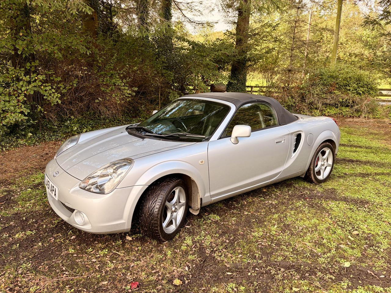

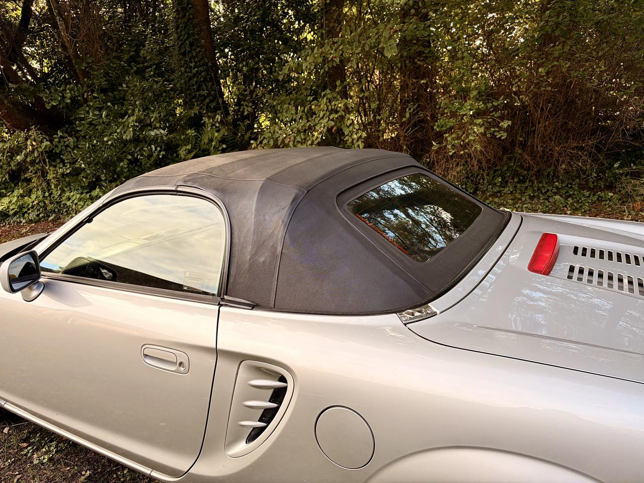

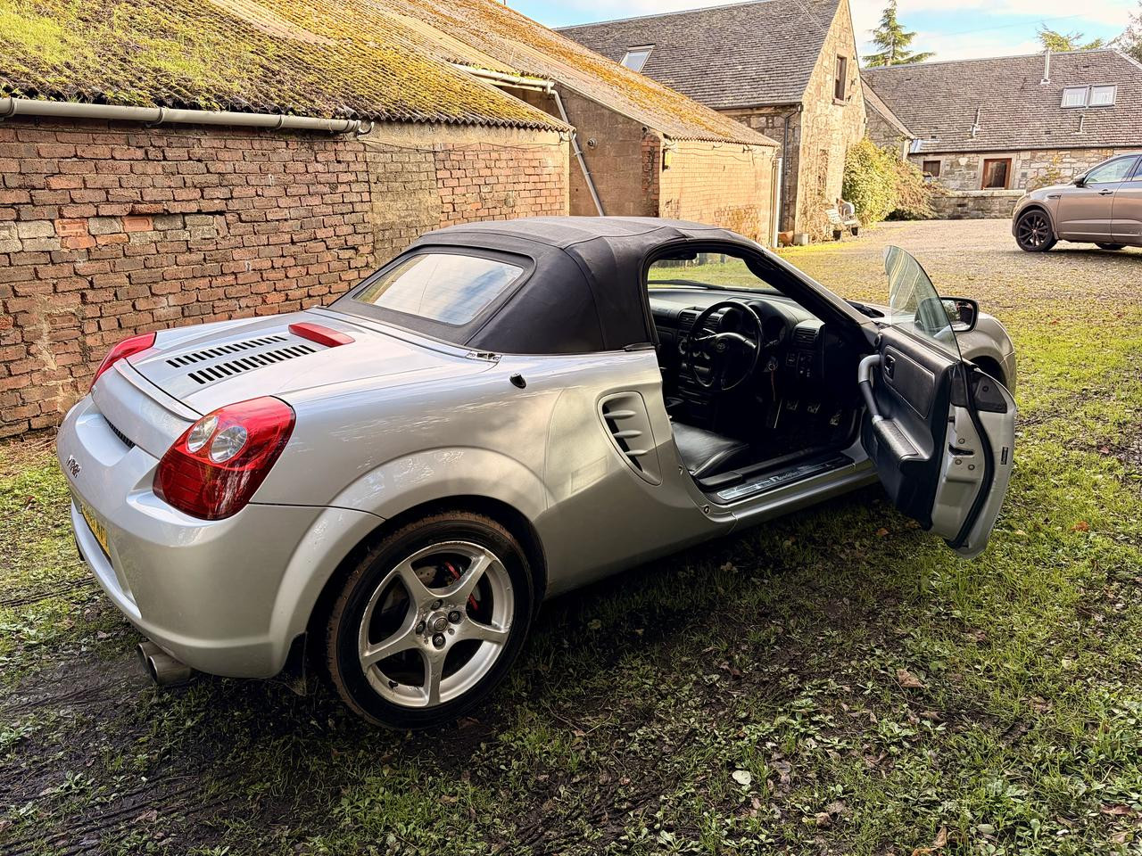

Last post by poprock - October 11, 2026, 16:07
#60
General / Re: Soft top Replacemnt
Last post by poprock - October 11, 2026, 14:58
I'd forgotten about this thread.
Just to update ... this was put on hold while the car had not one, but two engine swaps along with a lot of other work. But Andy at J-Spec fitted an A1-condition soft top for me last month and it's looking great. I've driven in torrential rain without a single leak. Great stuff.
