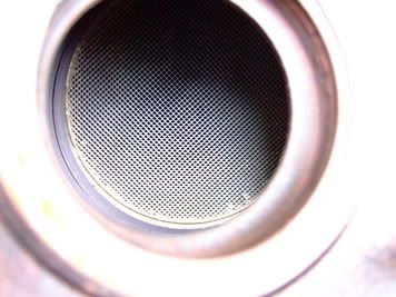

Ladies & Gents the officalresults of teh day are as follows;
Kanujunkie 31000 miles, cat condition perfect
Raodsterboy (mileage not recorded, Javier can you let me know) cat condition perfect
MR_2 (Mileage unknown, Adrian can you let me know) cat condition perfect
Simon C 58K (But 2nd engine) Cats ok but minor pitting
MRSMR2 16945 miles, cat condition perfect
Darth Paul, 18600 miles, cat condition perfect
Ernie Ball 16875 miles cat condition uncertain as we gutted from below, however what we could see was ok.
Roger, 5500 miles, cat condition perfect.
So all in all surprisingly good results this time around, but still worthwhile preventative maintenance.

Few pictures:
I don't know who these belong to as I had it written on the paper I left at Marks!
Simon shows off his manifold!
