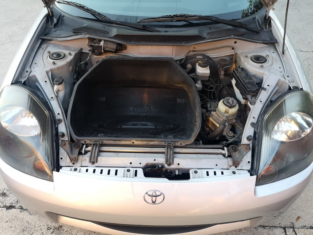

Gave the cabin some work and love today. Took the seats out etc and hoovered it. Found some mouse poop, tiny fragments of broken glass (some glass was smashed at at certain time no doubt), a broken pencil - fun times!
Great to see where the engine sits, how long is the wheel  base and the seating position of the driver - a truly well though out design just longing for some upgrades  >:D

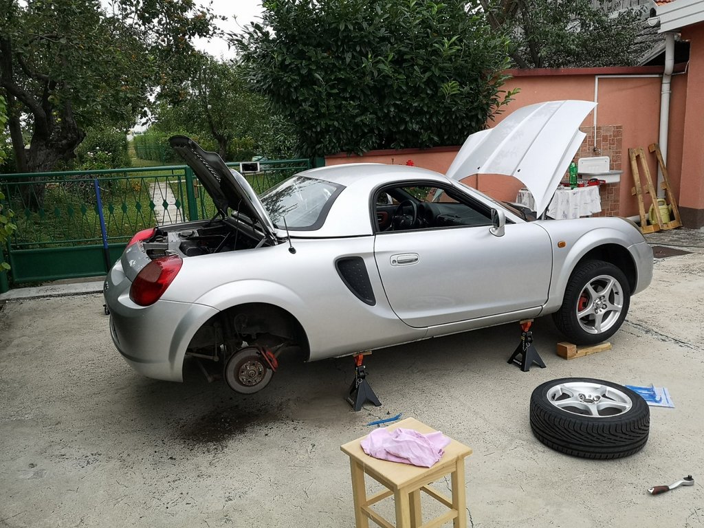

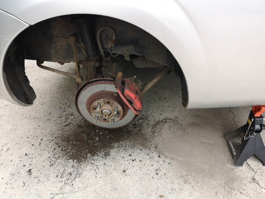

Today Ive continued to remove stuff, front licence plate, tools, spare tire, stickers... Also tried to lift the care and put it on jack stands to have a good look underneath but no luck as my lift can only do 35 cm and my stands start at that height. Need to upgrade my jack.
On the parts side Ive messaged boys from SJ via facebook and got a reply from Matt from Rogue motorsport. Also Ive found a potential donor car in Ireland. At the moment not willing to spend funds on that now but keeping that option in mind.

"Today Ive continued to remove stuff, front licence plate, tools, spare tire, stickers... Also tried to lift the care and put it on jack stands to have a good look underneath but no luck as my lift can only do 35 cm and my stands start at that height. Need to upgrade my jack. "
I had the same problem. I use a block of wood having cut a suitable recess to locate it on the jack head. The remaining thickness of the block raises the lift height by that amount.
PS
This is a close call as you need to maintain clearance to get the jack under the lifting point .
Alternatively you can drive the wheels onto two long boards or four shorter boards to raise the car height.
FredyCro
Ive just bought a new pro jack, can lift up to 50 cm now with ease.

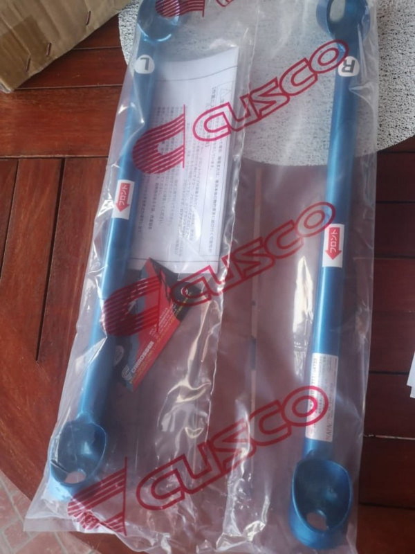

Im getting a package from Boris soon, bracing etc.:)
