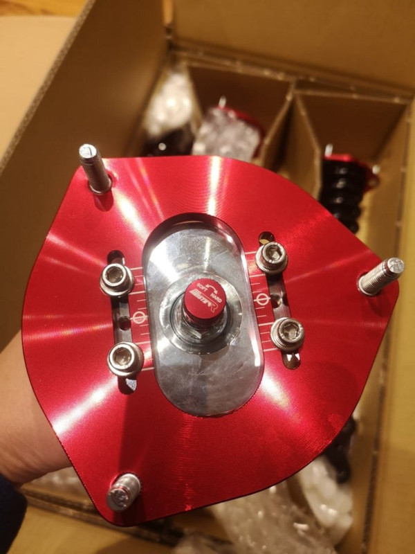

Few points, got a nice parcel feom mr Boris containing under mid brace and antenna hole cover.
Also if I get confirnation that I do not necessarily need type approval TUV for my homologation Ill go with meisterr zeta cdrs asap.
Have a great day all!

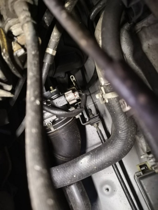

It took me more than an hour to adjust the slack in the throttle cable and had to use an extra pair of hands!

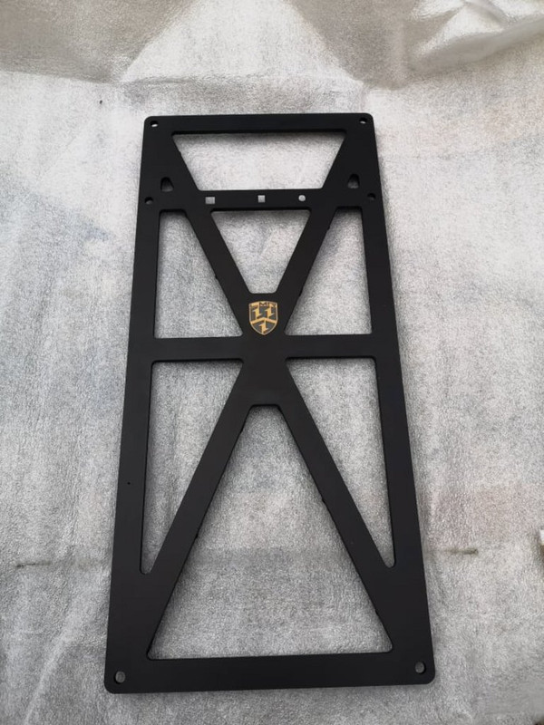

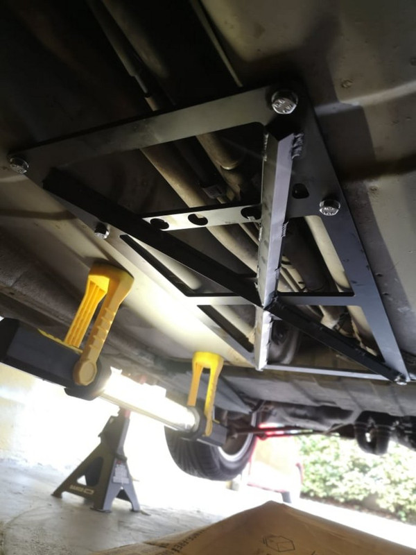

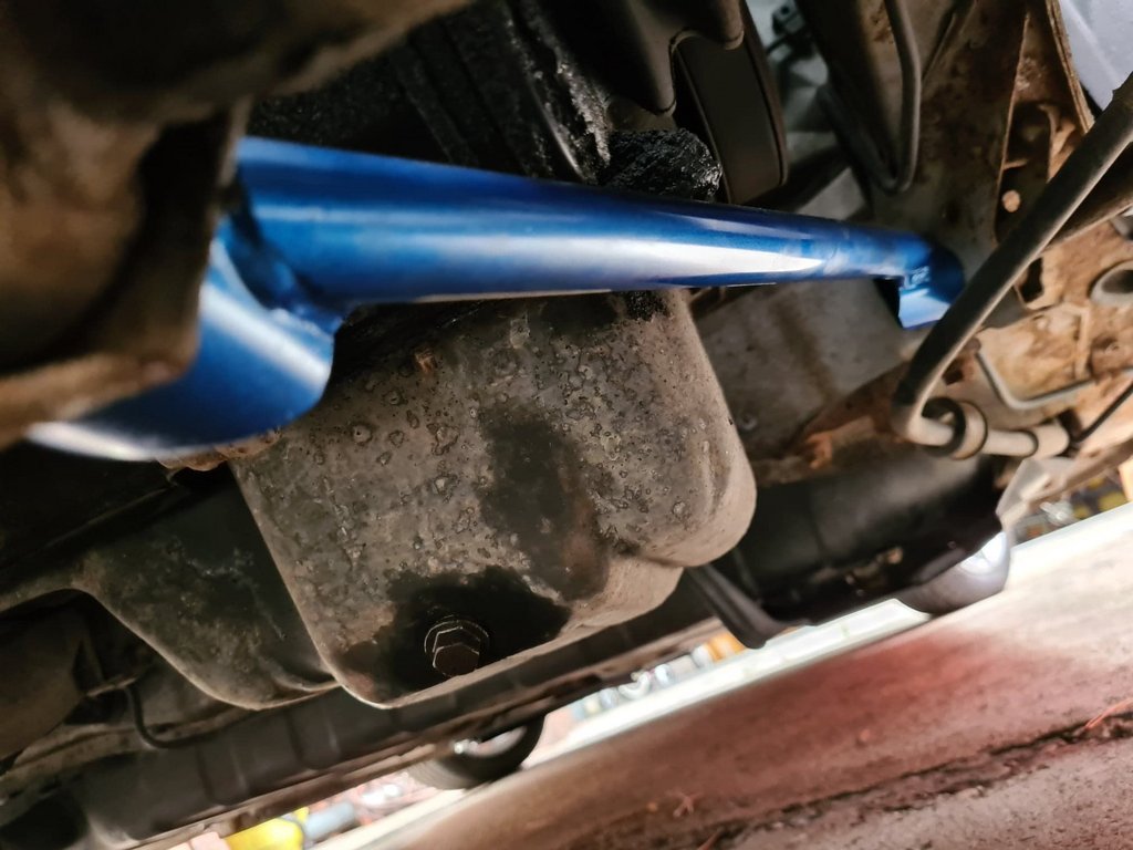

Breast plate from you know whom has been installed, so far great experience and it looks amazing. Two of my shocks are gone so Im not going to try to evaluate the effect of it before I install new coils. Advice, smart thing would be to torque it down to recommended torque. Ive thought its OK until I used my torque wrench, I still had a lot of tightening to do.

On a different note Ive just placed an order for meisterr zeta kit, looking forward to it.

I still havent received my whiteline ARBs even though Ive ordered and paid more than a month ago. Also my meisterr zeta cdra havent arrived yet :(

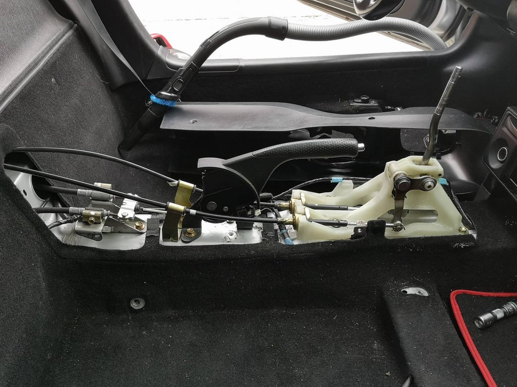

Spend a few hours yesterday around sorting antenna cable getting it out and trying to cut some slack off the handbrake cable. Next part is to remove the back installation completely and install Boris's cover for the antenna hole.

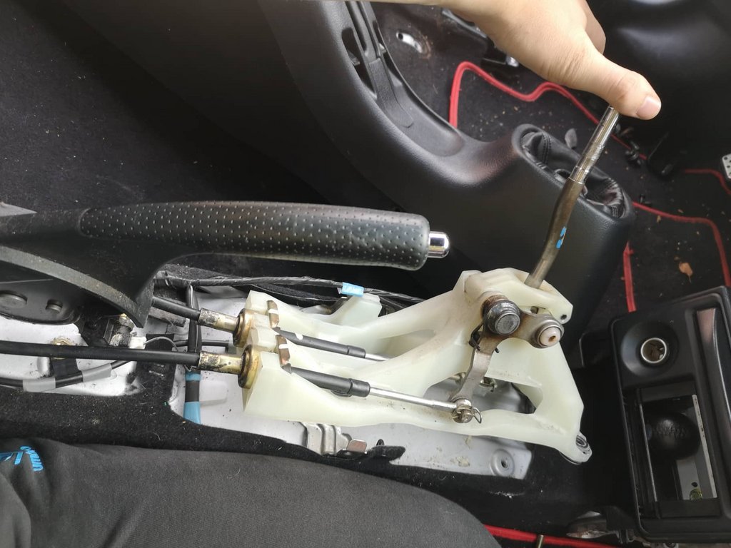

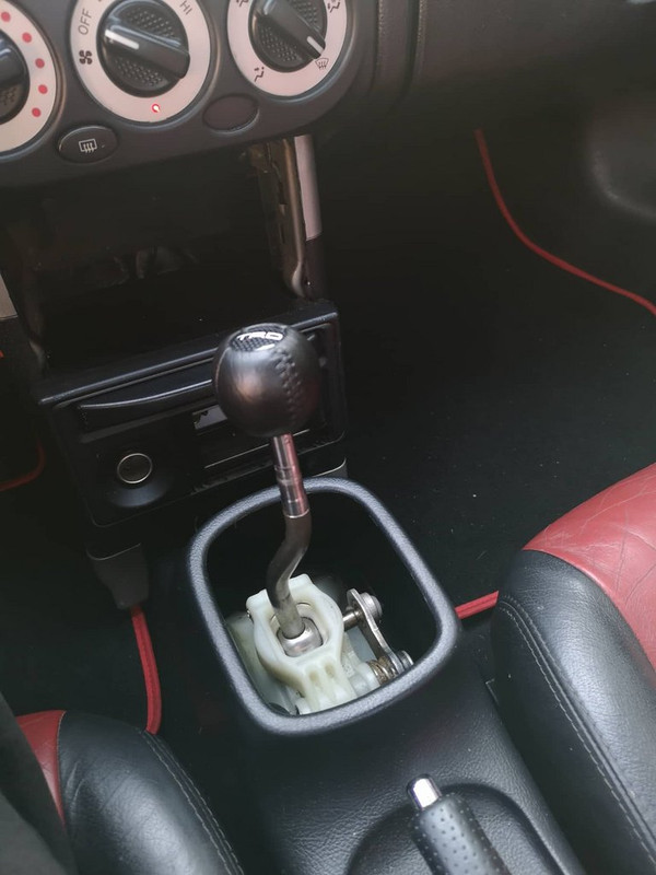

Removed the leather around the shifter and cleaned it all, found yet again as always in parts when I haven't looked before, some mouse poop and parts of broken security glass. this cars window was smashed and mouse's lived in it that's for sure :D
IG: optimal_zzw30
I rather like the exposed linkage look.
I won't be doing it myself.
Due to the stuff, I will inevitably lose down it.
 But looks good.
Jimbo
Wondering whether you could get a metal replacement for the plastic bits inside but I guess that wouldn't move so smoothly! Nice open gate?

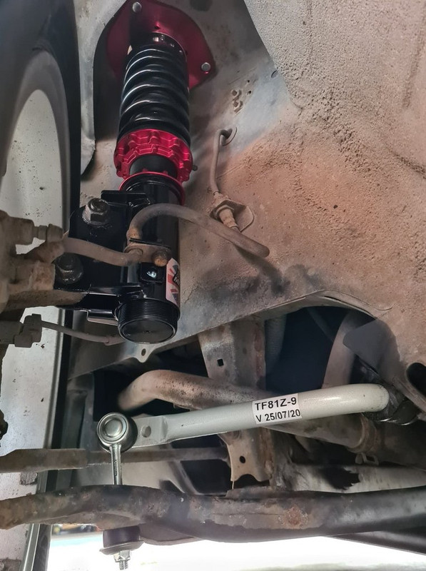

Still waiting for whiteline ARBs, apparently theyve been discontinued for some time but should be available very soon. Until then my meisterr zetas have arrived.
IG: optimal_zzw30

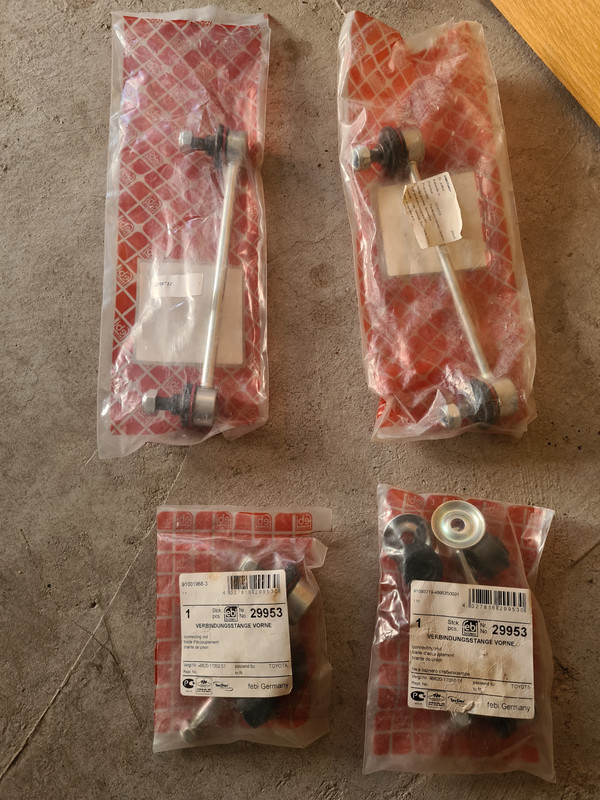

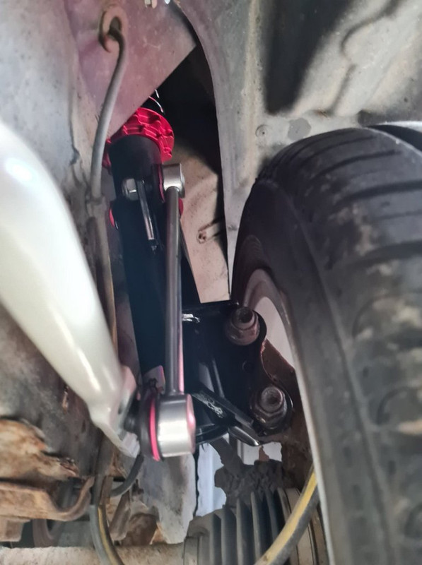

Few other parts have arrived to solve the suspension puzzle for the time being. It should all come together next week
IG: optimal_zzw30
FredyCro

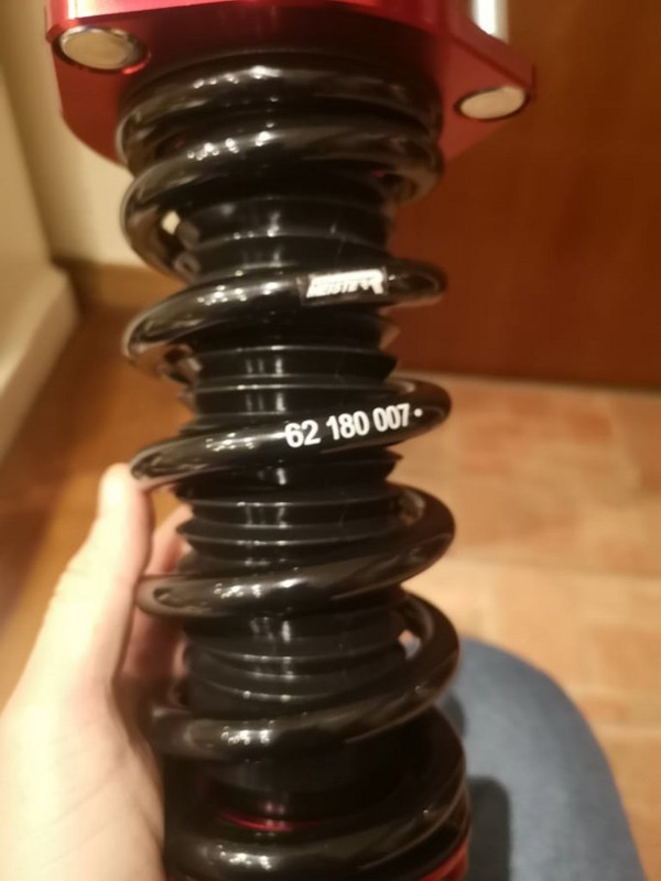

Slowly but surely...
Next step is wheel alignment and suspension setup. Depending on covid crap Ill go thru or wait with k24 upgrade this winter, things arent looking pretty so far.
First impressions? Well what can I tell - you when you upgrade from 20 y.o. busted shocks/ springs to meisterr/ whiteline/ cusco :)
