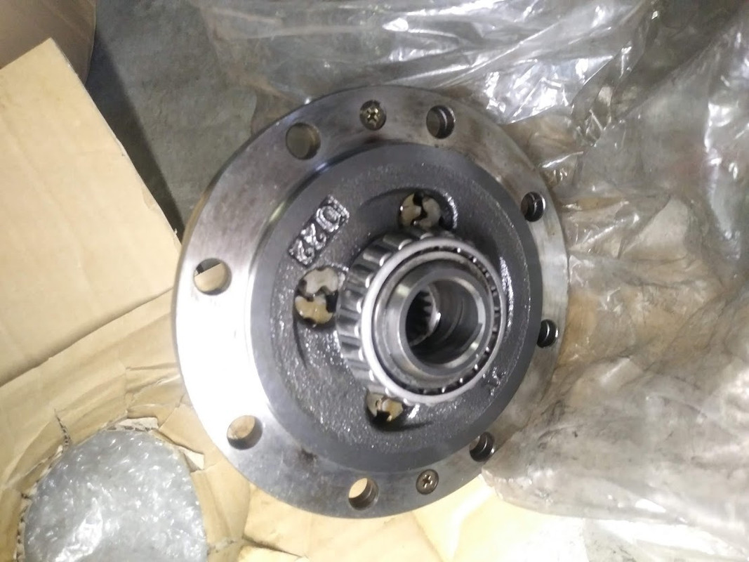

Ive ordered LSD few days ago from Swiss (good deal too) and should have a pallet with my swap engine and bits next week in my yard. So far so good.

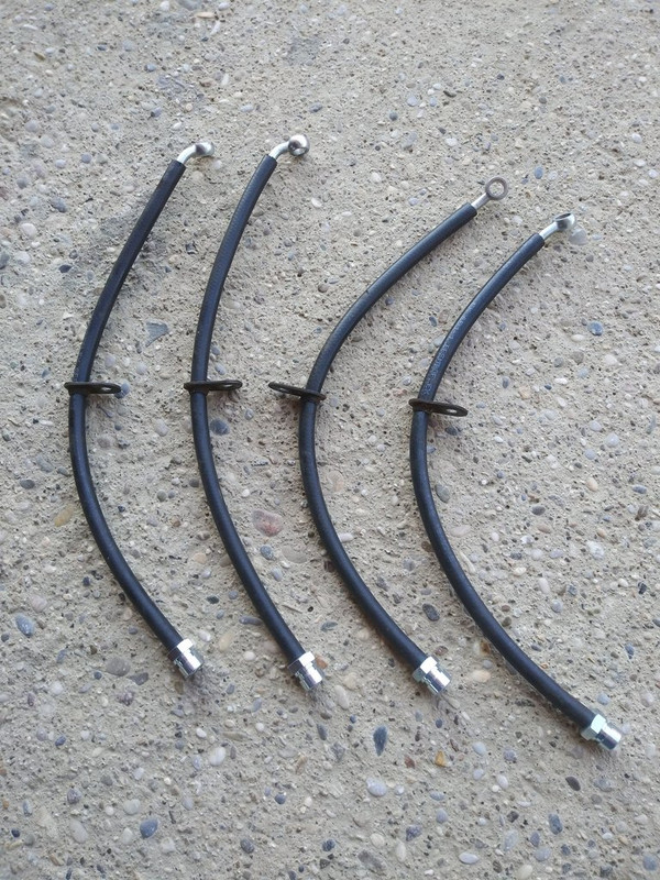

More stuff, Ill do custom braided lines here locally

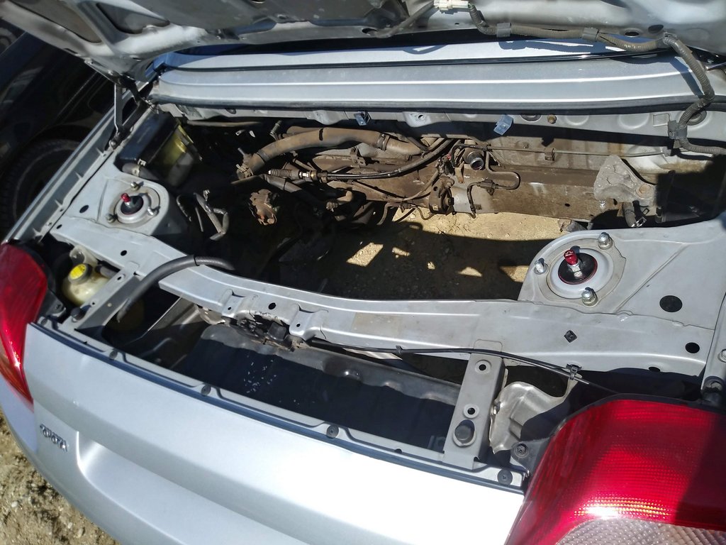

Car is off to a mechanic. He will rebuild the stock 1zz, insert LSD into my stock 5 spd box, completely overhaul brakes and other bits. Hopefully Ill be on the road in few weeks time :)
Didnt go with any swap ATM, this seems like the most affordable option vs 2zz/k24 which Ive planned and would go thru if it wasnt for brexit/ covid.

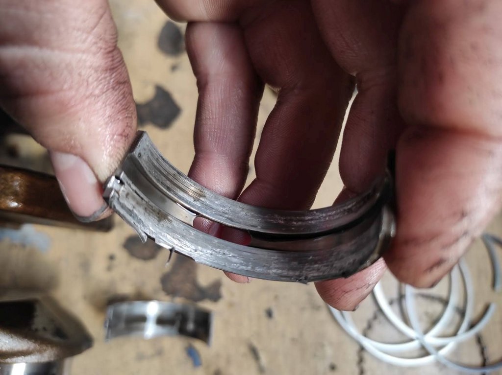

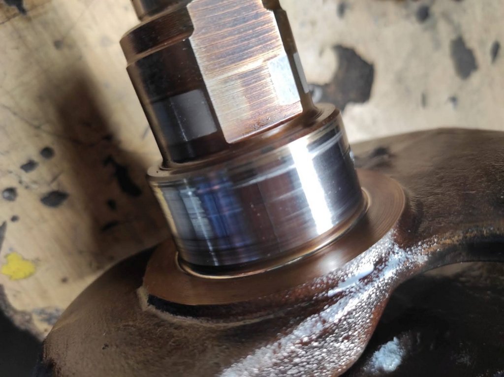

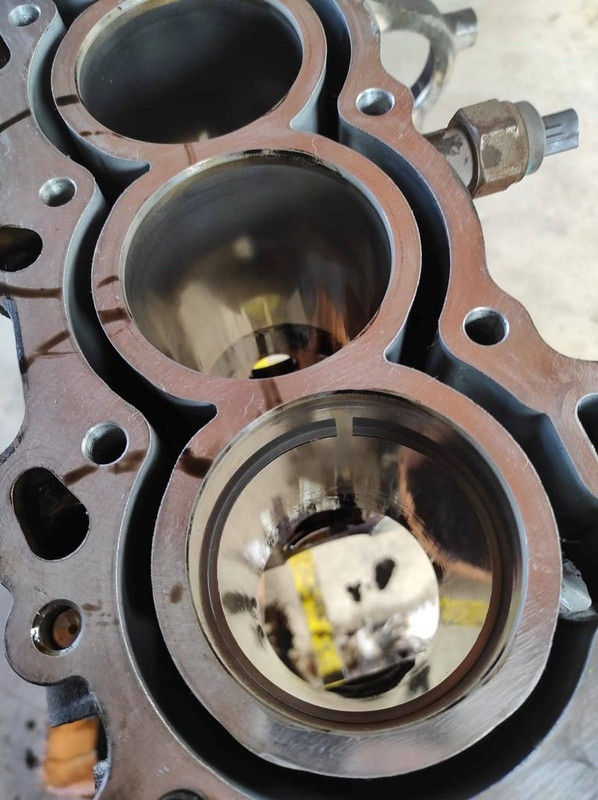

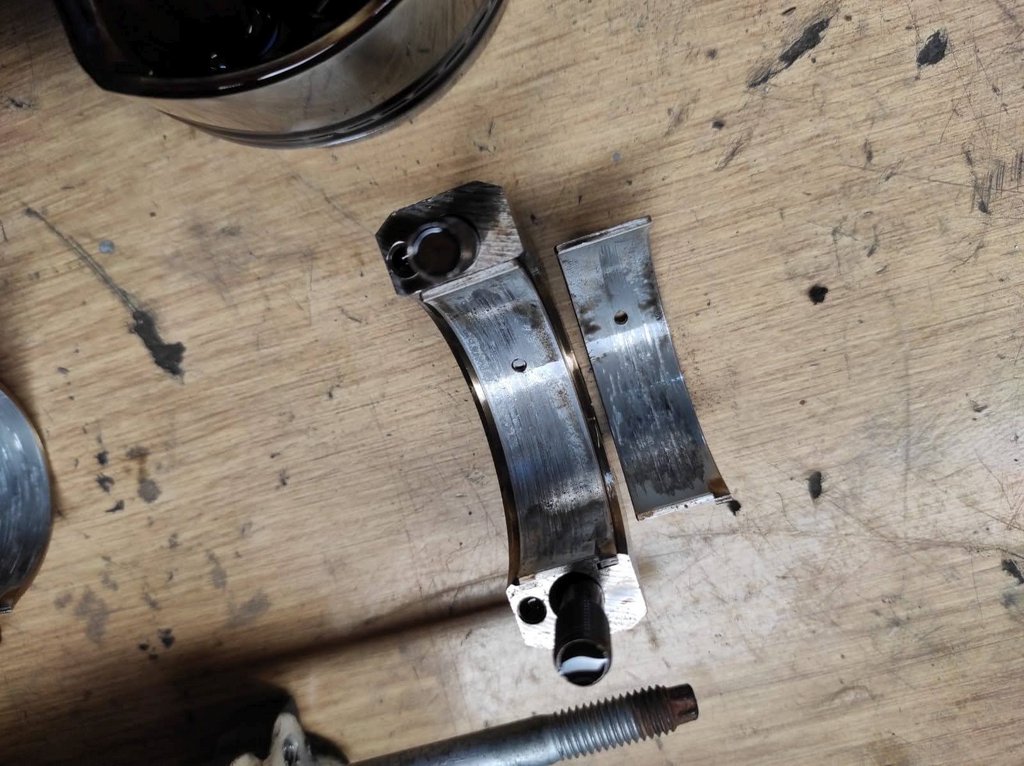

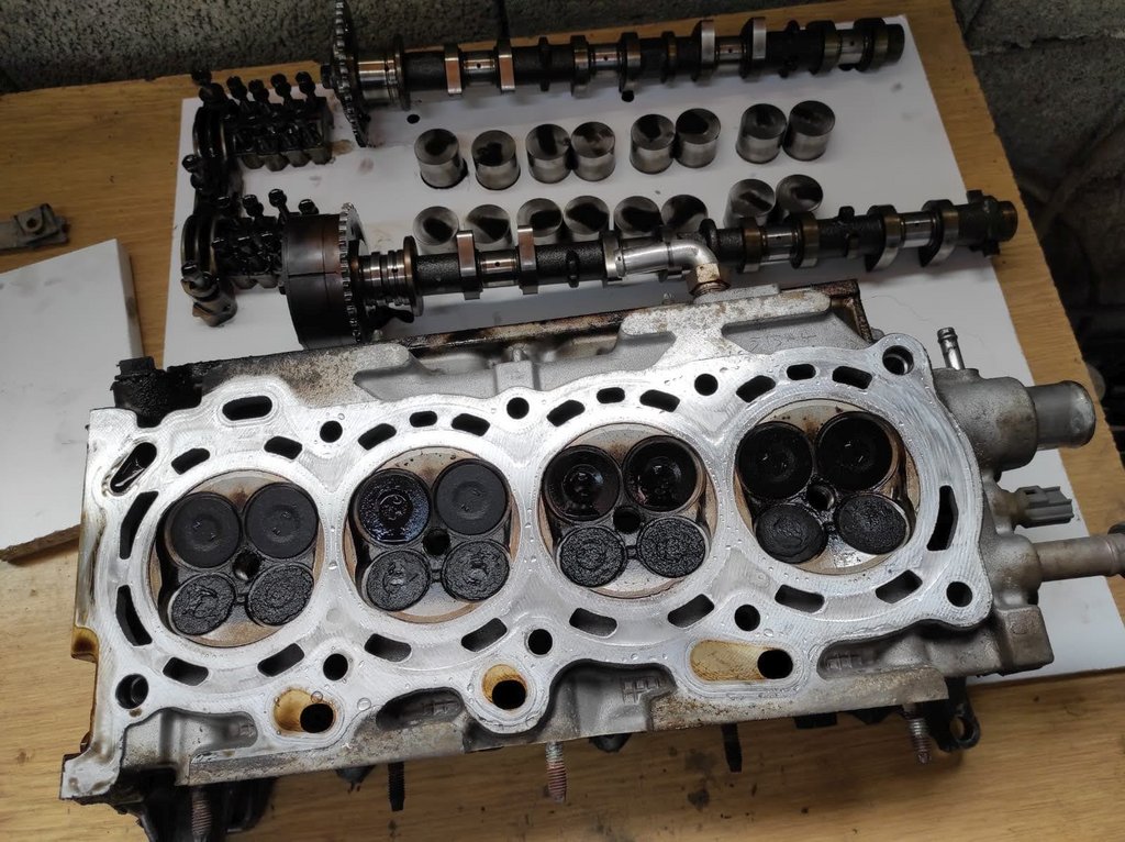

An update
upload img
IG: optimal_zzw30
Ouch. Crank OK? Looks like a bit of emery paper wouldn't go amiss haha
Are you getting bigger/more holes drilled in the pistons or just replacing?
FredyCro
Quote from: shnazzle on March 26, 2021, 22:56Ouch. Crank OK? Looks like a bit of emery paper wouldn't go amiss haha
Crank is most certainly not ok but its will not be disastrous by the looks of it. Ill know more today and also whats the situation with cylinder walls.
Plan is to just replace piston rings. Also chain tensioner is not great but it can do probably minimum 30 000 miles more. By that time Ill either boost this 1zz or do a swap and do a N/A build honda or toyota will see.
There is one crazy guy in the UK doing 1.9 tdi swap kit as we speak for our car. Who knows maybe Ill do the unspeakable, dark side when boosted has its perks :D
IG: optimal_zzw30
FredyCro
#93
So bottom line my old/ stock engine was not worth saving. Crank was damaged, so as cylinder walls, head needed full resresh etc. so I opted to source used but in good condition 1zz engine. Got in touch with good ppl from UK, Swiss, DE but at the end found one still in a completely smashed zzw30 - lucky find. Engine seems to be running OK with no smoke or weird noises and got a good deal so went for it.

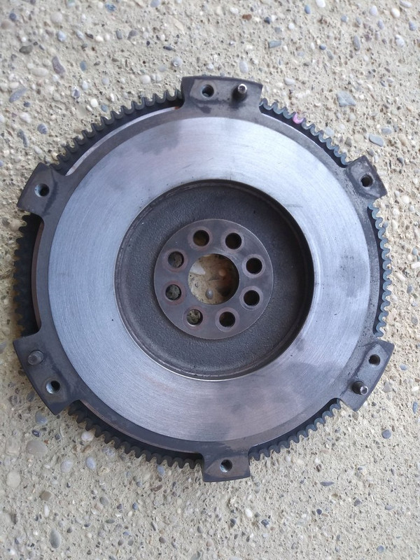

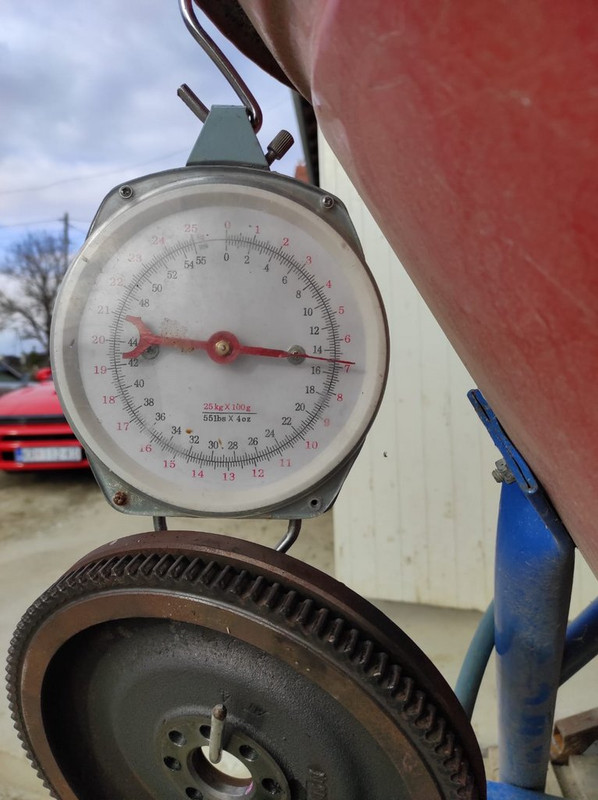

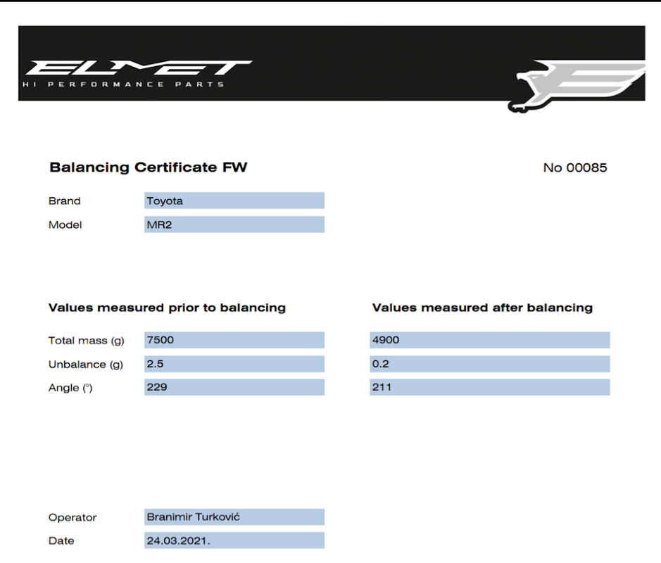

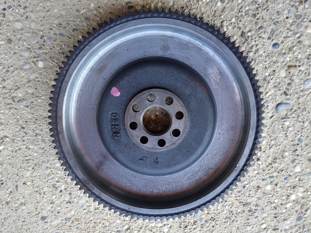

Here is a balancing report of my stock flywheel - my friend did a good job. highly recommended. Here is his business page https://elmet.hr/automoto%20performance%20tuning%20eng.html

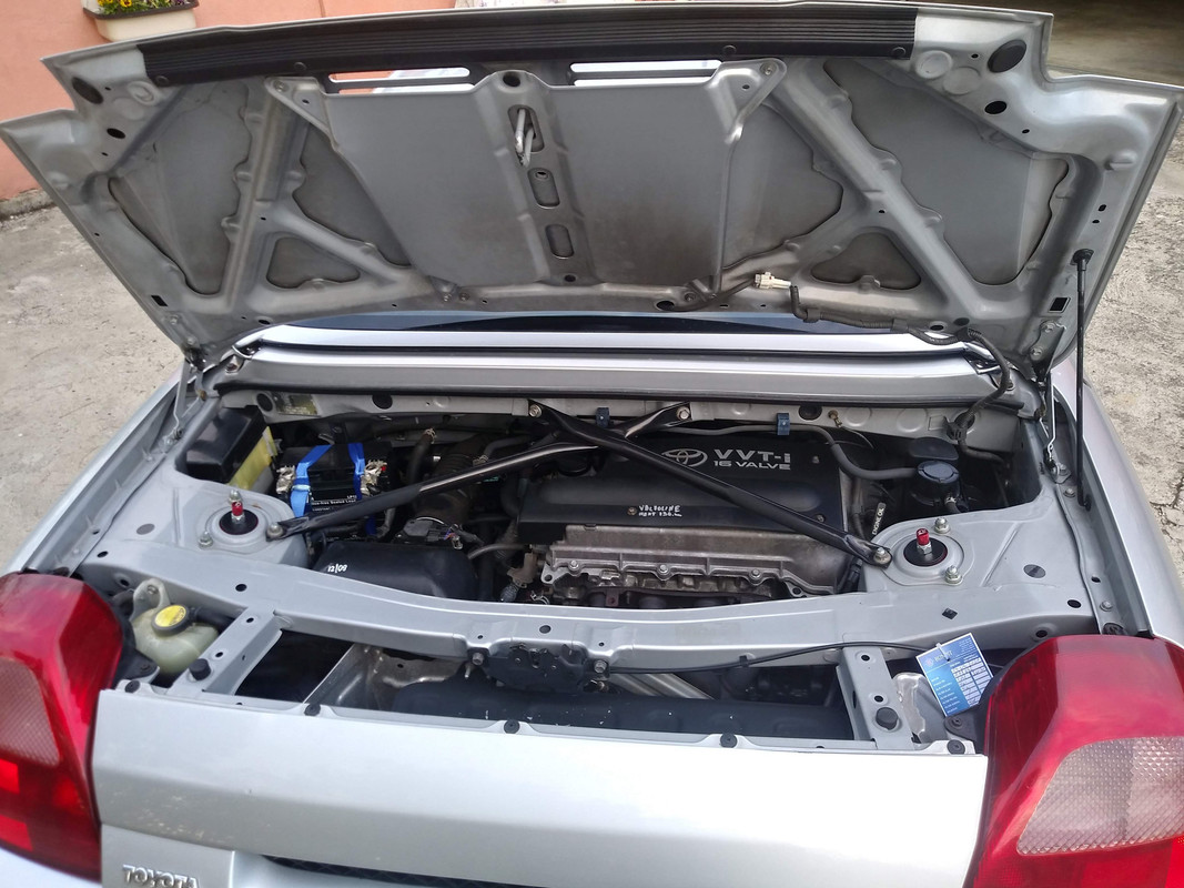

Cars done for this phase. "New" engine from 2003 is in, completely refreshed, lightened flywheel, new clutch, helical LSD, new lighter battery (5 kg), complete breaking sistem overhaul (ATE power, EBC, braided lines, motul brake fluid, pagid), undertray...
Still got an alignment to do today and it will take some time for the ECU to adjust to a good working healthy engine.
