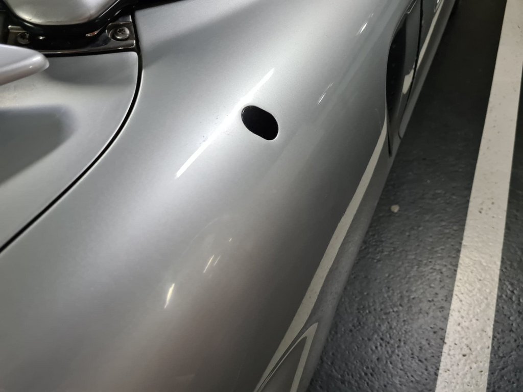

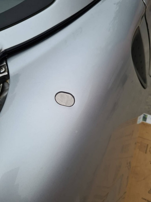

Anyways put Boris's antenna kit into good use and deleted the old fugly antenna. next step is to put te top metal bit. So far so good. A soul satisfing mod, must say metal bits are manufactured with high precision, well recommended piece of kit for anybody interested in doing the same.
IG: optimal_zzw30
FredyCro
Final product

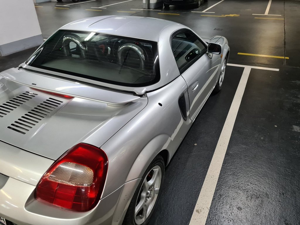

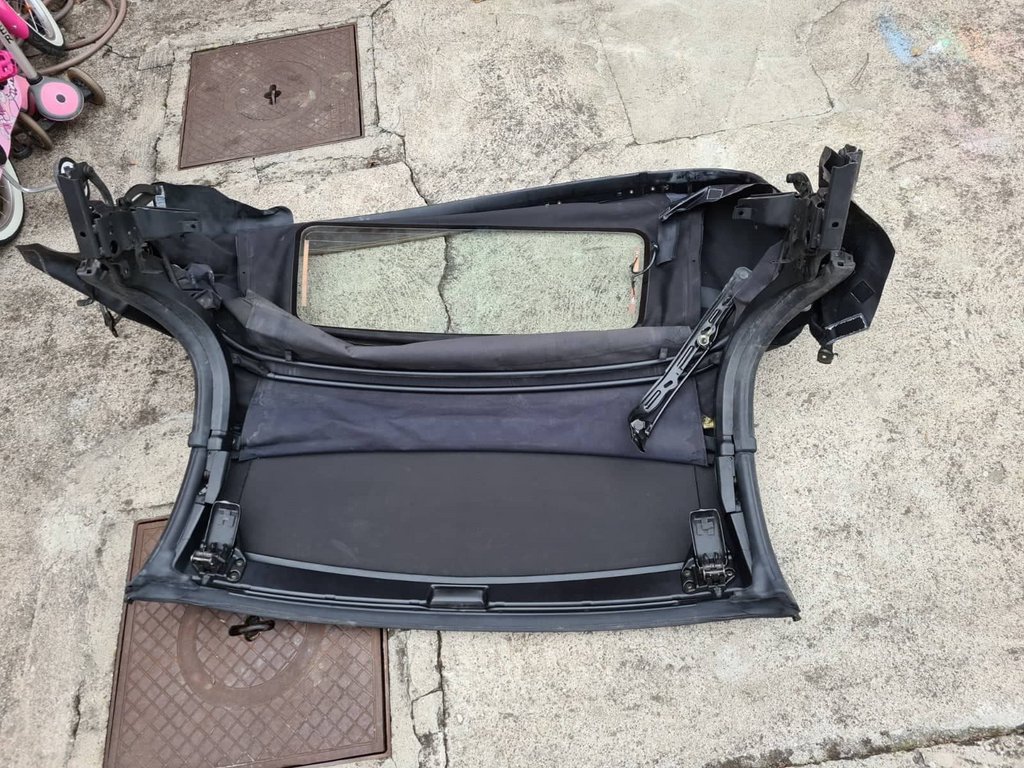

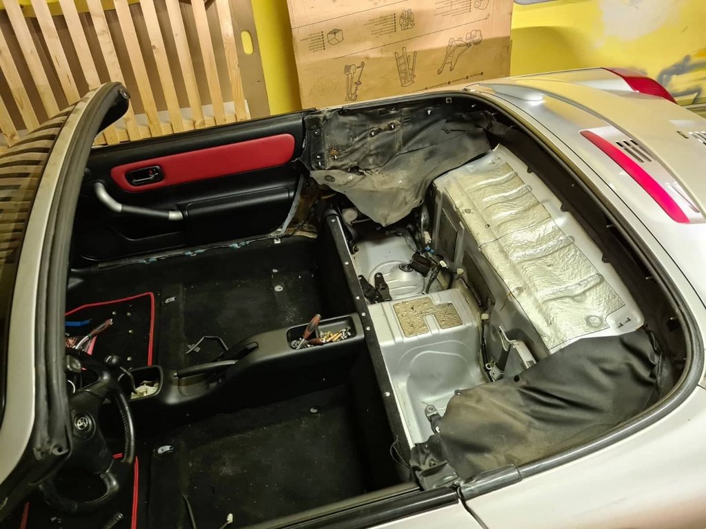

Deleted the soft top, had a few days time to spare and it was poor weather outside so what else to do :)
IG: optimal_zzw30
Hammond
Quote from: FredyCro on December  4, 2020, 14:58Deleted the soft top, had a few days time to spare and it was poor weather outside so what else to do :)
Nice work! How long did it take you roughly? Did you follow a guide? How did you overcome the seatbelt issue? I'm looking to do this soon :)
05' silver
FredyCro
Cheers!

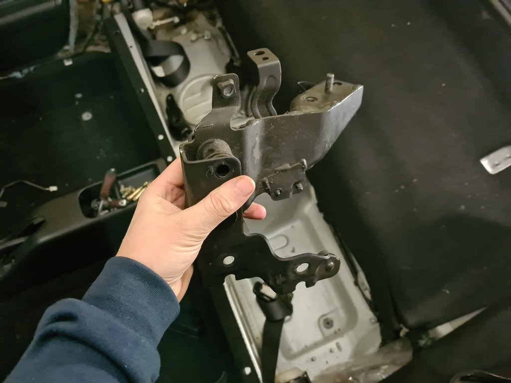

This was done during three afternoons of relaxed work + visit to a friend who borrowed me electrical saw to cut off the bracket from the rest of the soft top installation.
Im attaching the part Ive taken off and reused to make the whole thing look tidy and keeping the intended structural integrity.
Overall not a complex task just make sure to have some power tool for screw/ unscrew tasks and be patient and thorough with all the nuts n bolts. Also take plenty of pictures to be able to recollect how to bring everything back (lost of similar screws).

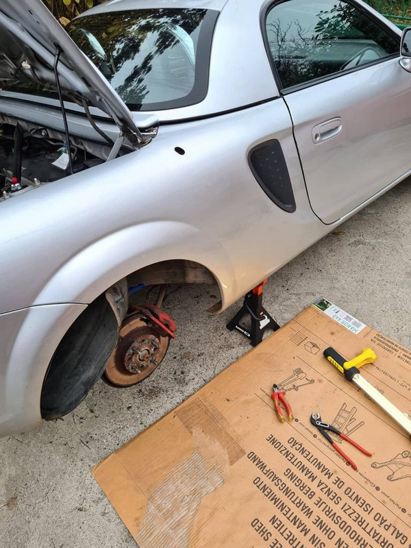

Moving onto whats next Ill probably upgrade the brakes as it is not so $$$ expensive and Im having now on a more regular basis overheating from back left brakes. Im guessing nobody put any money besides brake pads into brakes since it was manufactured 20 years ago by the looks of it.

Onto the next set of challenges - Im very unhappy with the brake feel and occasional rear left brake not letting go after using the hand break which results in smoke and overheating. So next big-mini project bill be to sort out them brakes - all around completely. I plan to go ahead with new stock-ish discs, pads (green/ yellow stuff level), braided lines, brake fluid (5.1?). Any good best buy web shops to get it all at once? Will probably also refurbish calipers and well everything needed really as by the looks of it nothing was tone to the braking system since the car was made besides changing pads...

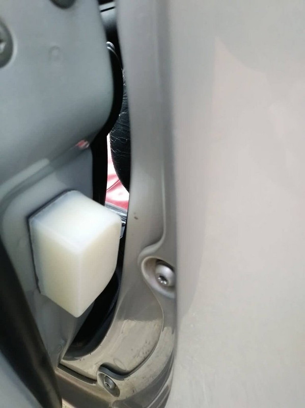

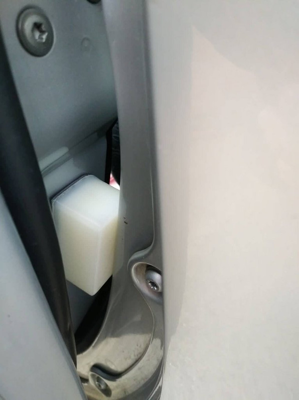

My door bushings have arrived, thanks @Dev
Will give feedback after the install in a few days time

Ive installed the bushings. My first impressions are positive, doors close now much firmer and torsion rigidity has improved significantly (most obvious when climbing any elevated surface i.e. street curb).

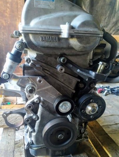

Ill do a 2ZZ swap and put an stock helical LSD into my 5 spd box by the looks of it. It is a more economical choice and should get me going and provide a more potent motor/ power transfer for minimum amount of hassle. Shoould get me thru the next winter and then we will continue with tte upgrade.
Sourced the engine in Hungary, originally from UK you dont say :) Some maintenance work has been done to it
